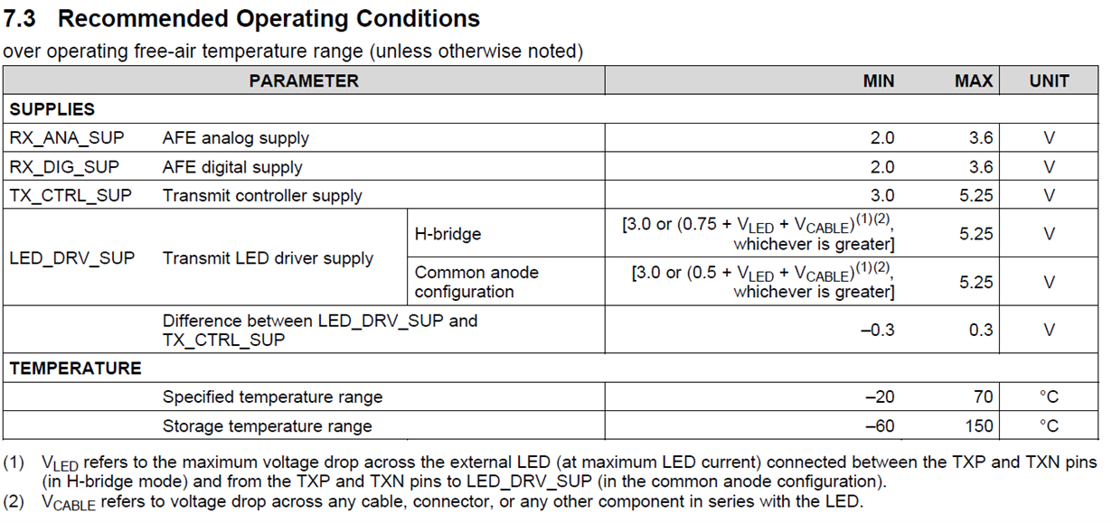

    When creating my custom AFE4403 PCB, is the H-bridge connection better for
    - lower LED power consumption
    - faster LED turn on time
    - get better readings from LED2-ALED2VAL, LED1-ALED1VAL
    I hoped to search benefits when using the H-bridge connection for the AFE4403 in the datasheet. However, I couldn't find it, so I'm asking this here.
  • Hi David,
    I would rather say, if your LEDs aren't connected back to back then you have option to connect them to the AFE in pull pull mode. In this option you can leave the supply to LED_DRV_SUP pin.
    However if you LEDs are connected in a back to back fashion, you have to use H Bridge mode and have to connect an external power source to the LED_DRV_SUP pin.
    There is no difference between the H bridge and the push pull mode with respect to power consumption, switching or LED on time.
    Only restriction I see is from the configuration of the LEDs in the optical module.
    Prabin.

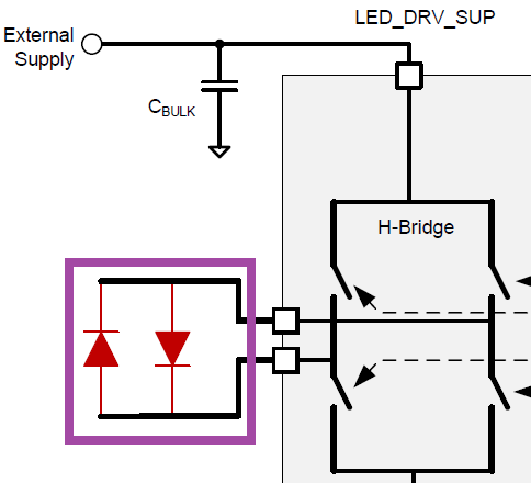

  • Thanks, Prabin.
    Just to clarify, does the "Back to Back" mean the connection described in the purple block?
    Aha, since there are other LED modules besides SPH7050, you mean that the AFE44 series was trying to provide more option to choose regarding the LED module?
    After double checking your meanings, I will close this thread. Thanks for your answer.
  • Hi David,
    Your understanding of the back to back connection is correct.
    Yes, AFE4403 gives you option to connect both types of optical module.
