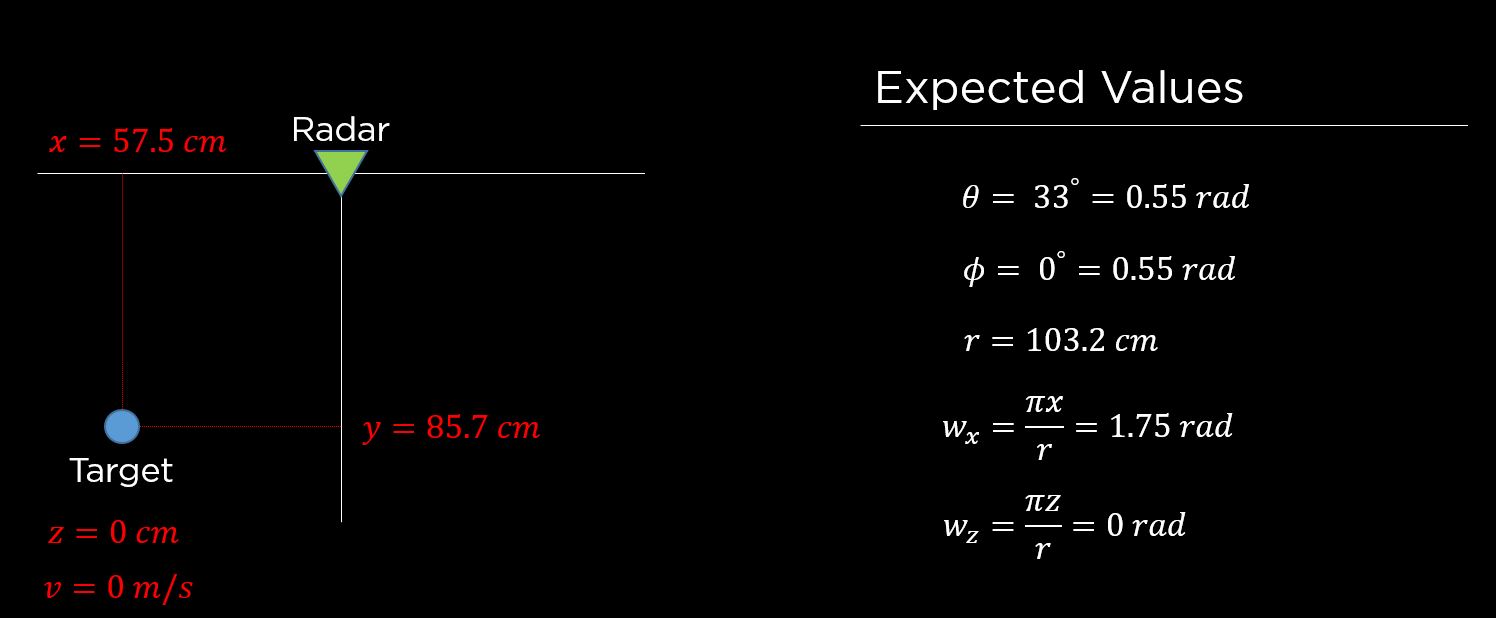

We are seeing a phase discontinuity between the RX channels from each TX antenna.
•The target is stationary, so this isn’t caused by Doppler shifts
•The target is at z=0, so it isn’t additional elevation phase
These phase jumps are causing additional peaks in the FFT and, as a result, errors in position estimation.
POINT TARGET EXAMPLE
VIRTUAL RX CHANNEL PHASE
AZIMUTH/ELEVATION FFT
  • Using only TX1 or TX3 gives the correct FFT peak, corresponding to 33 deg (wx = 1.75)
  • Combining TX1 and TX3 virtual channels gives the wrong peak, which corrupts the azimuth estimate
  • Incorrect wx and constant phase offset of TX2 phase gives incorrect value for z

    If you have fixed radial distance, and fixed angle, to a reference point on the antenna.    We would normally expect with MIMO processing with separate Tx1, and Tx3 Chirps,  That Rx1-4 with Tx1, would provide for Rx5-8 with Tx3.
    - if your phase discontinuity does not show up with this style of two chirps, one with Tx1 and one with Tx3, then the physical antenna locations would be expected to be OK    Tx1 -> Tx3 azimuth separation of 2*lambda, Rx1->Rx2-> Rx3-> Rx4 azimuth separation of lambda/2.
    - we would expect the L3 data collected over CCS, or the use of DevPack&TSW1400 or DCA1000 over two chirps for the Rx receiver to provide for the 4 actual Rx, and Tx3 pseudo Rx antennas.
    - in the case where you have activated Tx1 and Tx3 at the same time,  did you apply BPM to one of these Transmitters so you can separate  the phase difference?   The Tx1 and Tx3 with the same Tx-phase will have a different radial distance and have two frequency peaks at each receiver.   Using the BPM for one of the Tx outputs, and separately processing the Rx1.4
    - over the range of the chirp, the antenna spacing in phase changes.  If you cover a smaller chirp range does the behavior change.
    - I have included the antenna designer simulation of the antenna, I don't have the IWr1443 antenna characterization report for the EVM, I will ask the other engineers.
    - as another application engineer has asked, if you can send the config file, and FMCW Rx data over the separate Tx1, separate Tx3, combined Tx1, Tx3 Rx data we can look at those items.
