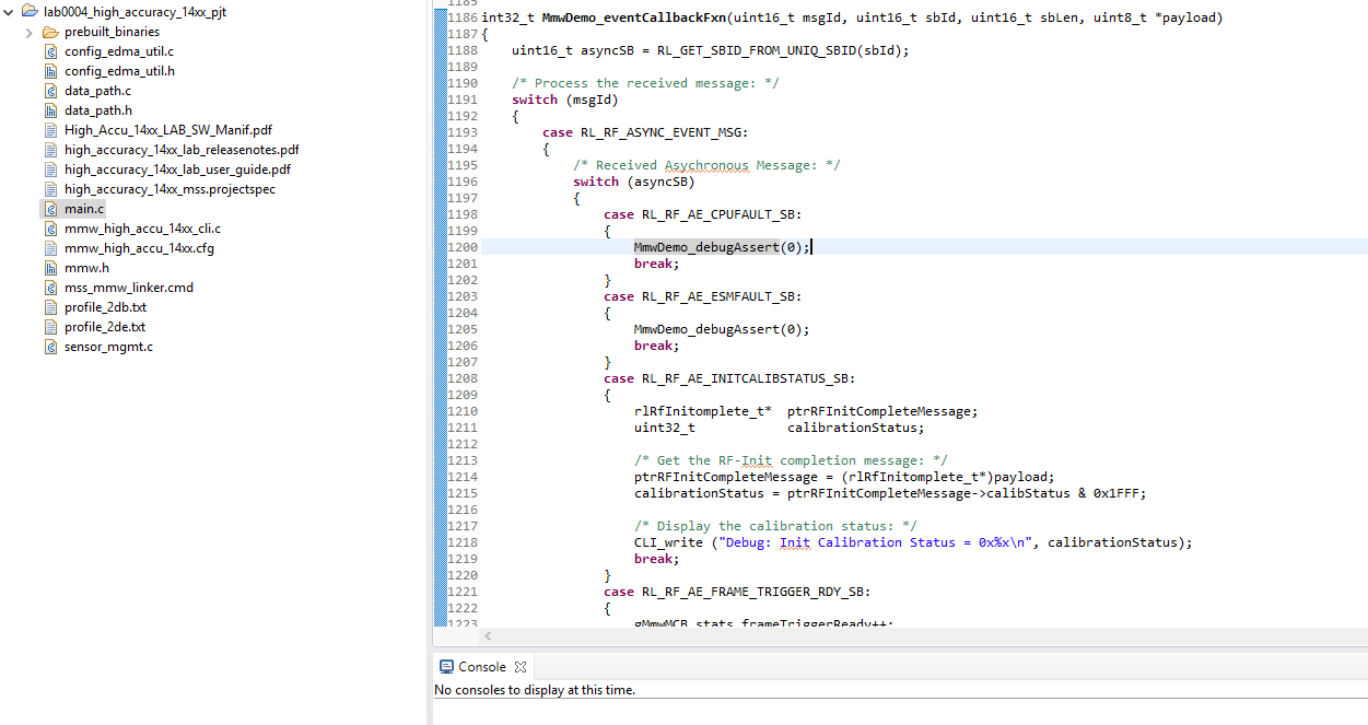

I have created a custom PCB that utilizes the IWR1443 sensor for level sensing application.  So far, I am able to flash the highAccuracy lab demo to the external flash memory (part# MX25R1635FZNIH0) via UniFlash.  Using the CLI commands I am able to execute all of the commands and receive acknowledgement as shown below.  However, when I send the command to start the sensor, it fails.   Can someone help be start the debug process?  I have had two different errors pop up in the Uart output and you can see the CLI commands I am sending below.  I'm hoping that someone has run into this same error while developing and point me in the right direction.  Thanks!

mmwDemo:/>sensorStart
Debug: Init Calibration Status = 0x5fe
Exception: ../main.c, line 1045.
Exception: ../main.c, line 1200.

        1) in your first example "
    Debug: Init Calibration Status = 0x5fe"
    The BSS processors performed a calibration, and returned the status.
    For IWr1443, the normal calibration status is
    Debug: Init Calibration Status = 0x7fe
    Done
    The Interface Control Document - 5.2.9, the bit mask of tests
    bits 12 .. 4 are active tests.
    Each of the tests, can be enabled or disabled.
    If you go through a device reset, and program with the OOB demo, and visualizer, the terminal window,
    if the internal calibration continues to fail, this would be internal to the device.   You need to see if you have a repetitive error.
    you would reflow or replace the part.  The calibration does not use the antenna, it has internal loopback.
    If you use the Visualizer - OOB first, and you get the RF calibration Done, you
    can do an antenna test/ range test.
    The antenna pattern test, azimuth and elevation, can be checked by recording the Visualizer response, or
    using CCS capture the L3 memory, for the receiver data, or 1D FFT data.

    2) Calibration failure - if the calibration value after RFInit is not 0x7fe, there is a device failure, device to board failure, or a power failure.
    if the device is a IWR1642 ES2 or IWR1443 ES3 device, you need to have the proper BSS patch.
    You can recompile the OOB demo, so that your calibration status is OK, by not running that test with the calibration setup mask
    (ie if your OOB calibration status is 0x5fe, you could recompile the code to only perform the 0x5fe bit mask).  the radar may not work properly,
    but if the bit mask is the same after calibration the software should allow RF Chirp.
    Debug: Init Calibration Status = 0x1fe
    Exception: ../main.c, line 1671.
    "if the device is a IWR1642 ES2 or IWR1443 ES3 device, you need to have the proper BSS patch."
    I have uploaded the radarss.bin file found in the mmWaveSDK  1.2.0.5.  As far as the silicon version, I am still unsure of how to determine.  I assume it's rev 2?

  • Joe,
    We have traced it down to few lines of code.  It is not the same error code or exception in the code every time.  I have traced one error down to "CPU Failure" along with general ones that don't really indicate what the problem is.  Now that we are this far along and I have a semi-consistent hardware stack, I will try a few more radar assemblies and see if I can get one to pass startup tests.  I think I have about 5 assemblies that I can get consistent results out of.
    I'm hoping that now that we at least have JTAG and some better debugging tools I can figure out what exactly is causing the failure.
    Do you think it could me timing issues with QSPI signals?  I know they are not matched exactly. I figure the fact that we are flashing bin files to flash, we are ok with the QSPI signals?  Could that cause a calibration error?

  • Joe,
    Where would I edit the calibration bit mask in the code?  I haven't been able to find any details on the calibration process.  Can you share any details on what tasks are performed in the calibration process when starting the sensor?  I'd like to setup a breakpoint and step into the calibration portion of the code and maybe see if there are any clues but I'm not sure where to set my breakpoint.
  • Hello
    Currently you would need to customize the out of box demo. Look for MMWave_openLink() in mmwave_link.c.
    in future mmwave_sdk version 3.0 it can be adjusted. Currently you would have to modify the code to try other than 0x7fe as a mask.
    REgards,
    Joe Quintal
  • Joe,
    I can't find "MMWave_openLink" or the mmwaveLink.c file anywhere in the OOB demo? Can you be more specific on where this is located?
    Thanks!
  • I found it. C:\ti\mmwave_sdk_01_02_00_05\packages\ti\control\mmwave\src\mmwave_link.c
  • Hello Jason,
    "file:///C:/ti/mmwave_sdk_01_02_00_05/packages/ti/control/mmwave/docs/doxygen/html/mmwave__link_8c.html"
    Find this define #define MMWAVE_INIT_CALIB_SUCCESS 0x17FEU
    Change it to your return code.
    It should unblock your test.
    (remember to change it back)

  • Joe,
    Thanks.  The device is chirping and I am able to run the OOB demo and view plots in the Visualizer.  However, it appears as you suspected, that the radar is not working quite right.   It looks like a lot of noise on the plots and doesn't seem able to detect objects very well.    The Doppler seems to work OK but the sensor detects too many objects.
    I thought it was kind of odd but I can hear a subtle audible chirping coming from the sensor after It starts.   You have to listen close but it's there.  There is no way I'm hearing chirps in the 77GHz range but I am hearing a chirping sound about 10 times a second?  Does this mean anything to you?
    Anyway, from here is there any more clues to my apparent hardware problem that I can get through JTAG / Software Debugging?
