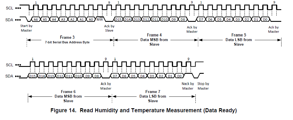

Let me ask a question about datasheet description that I'm wondered if my understanding is correct.
Regarding Figure 14, what is the difference between Data for Frame 4&5 and Data for Frame 6&7. The datasheet looks to say that both humidity and temperature data are consequently pulled by HDC1080 after only setting 7-bit Serial Bus Address Byte(Frame3) in both temperature and humidity mode(Bit[12]=1). Is it correct understanding? If yes, Frame 4&5 stands for temperature and Frame 6&7 stands for humidity, is it also correct? I'd like to make sure it clearly.
Thanks in advance.
