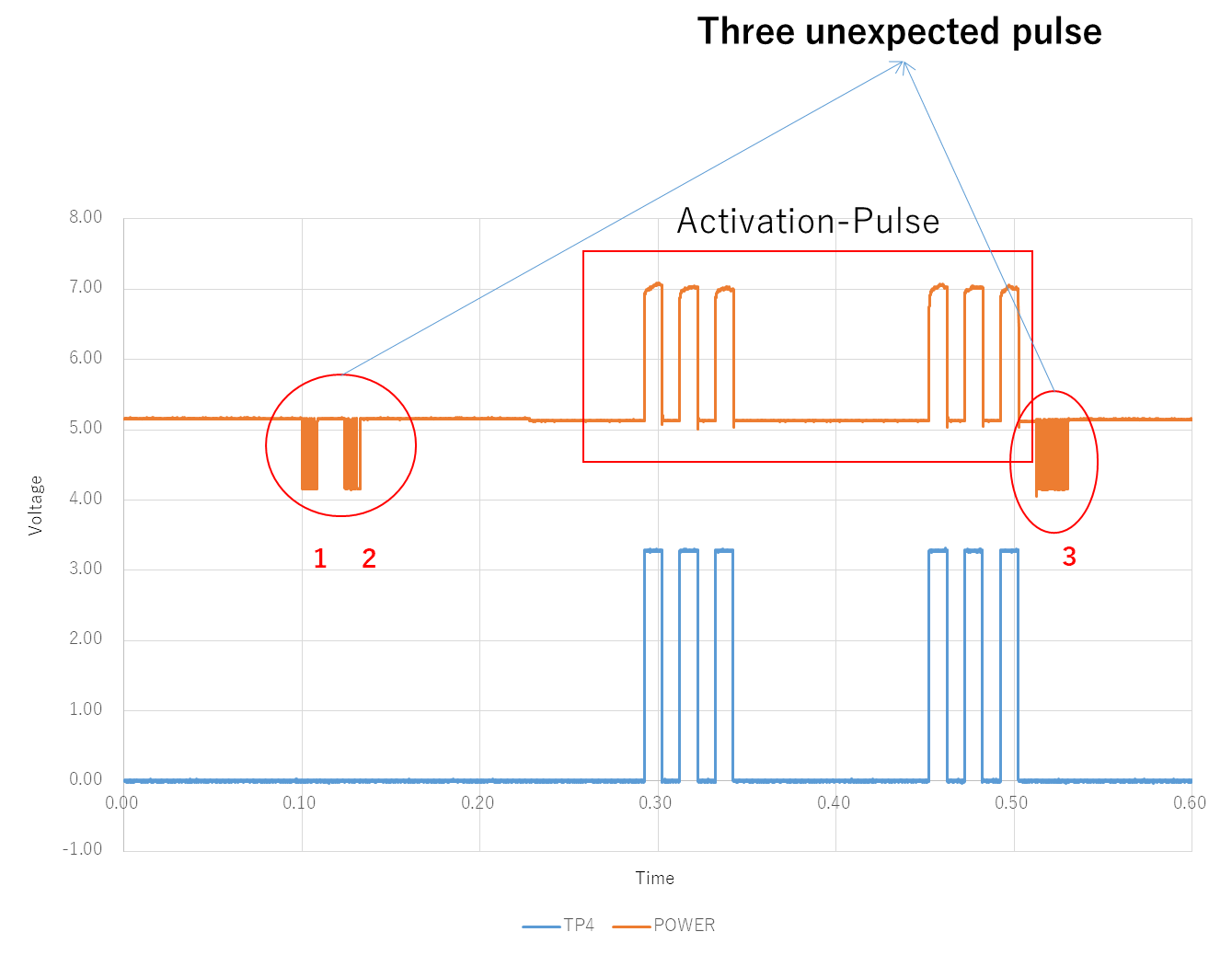

I would like you to confirm whether following behavior is expected result or not.
Could you please confirm ?
Customer perform following sequence.
1. EVM of PGA300 connect to PC via USB2ANY.
2. Perform "Activate OWI" on GUI. (They do not perform any operation except this on GUI)
3. Check activation pulse on "PWR" pin.

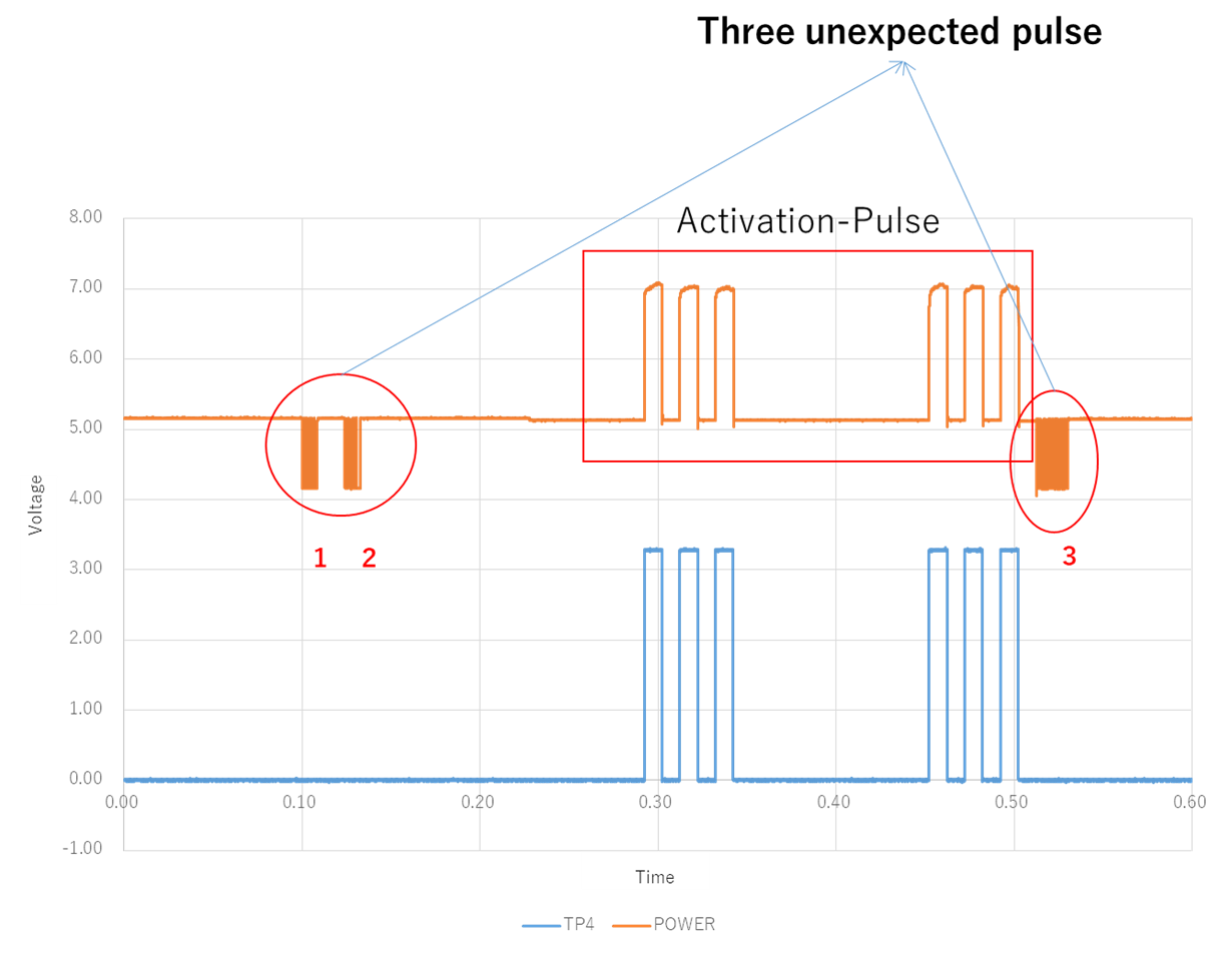

Then, they observed waveform which is NOT described in datasheet before/after Activation-Pulse as shown below.
  • Hi Machida-san,
    This is expected, and is a part of the GUI. It sends some additional OWI commands when the activation pulses are sent to confirm that the OWI communication is successful. This is how it knows to change the status indicator at the top of the GUI window.

    * You described  "It sends some additional OWI commands when the activation pulses are sent to confirm that the OWI communication is successful." in previous post.
    I understood that this means that we can see OWI communication pulse will be observed after activation pulse was sent.
    However, according to customer's waveform, OWI commuication pulse was observed before activation pulse was sent as well.
    Is that also expected result ?
    i understood that OWI communication pulse which we can confirm after activation pulse may be expected result. However, it seems that OWI communication pulse which we can confirm before activation pulse is NOT expected result..
  • Hi Machida-san,
    I will have to check again, but I believe that the first pulses are to check if the OWI is already active before sending the activation pulse again.

    According to detailed waveform of three, it seems that host controller send OWI write command in all three case.
    Again, what we would like you to confirm is
    1. This is expected waveform or not.
    2. In addtion, this is necessary in customer's system or not.
    Could you please send me your status ?
    Thanks in advance,
  • Hello Machida-san,
    It is normal for the EVM, but it is not necessary for OWI activation. Detailed instructions for activating OWI in normal use are included in the datasheet in the section titled: "Activating OWI Communication".

  • Hello Scott-san,
    >The customer can determine what is being communicated by reading the bits being sent in those transactions if they are curious.
    We confirmed waveform "before two" and "after one".
    1. waveform of "before two"
    The waveform structure was below.
    START bit -> Sync(8 bit (Value is "10101010xb")) -> STOP bit -> Wait(1bit)
    -> START bit -> Command(8bit (Value is "10000000xb", this means "OWI write")  -> STOP bit -> Wait(1bit)
    -> START bit -> Data 1 (8bit (Value is "00110000b", this means "Address is 0x30")  -> STOP bit -> Wait(1bit)
    -> START bit -> Data 2 (8bit (Value is "00000000b", this means "Written data is 0x00")  -> STOP bit
    2. waveform of "after one"
    -> START bit -> Data 1 (8bit (Value is "00010000b", this means "Address is 0x10")  -> STOP bit -> Wait(1bit)
    -> START bit -> Data 2 (8bit (Value is "10101010b", this means "Written data is 0xAA")  -> STOP bit
    All three waveforms mean that OWI write and access to "Reserved " region of OWI memory page(I referred to Table 4 of datasheet).
    So, we can NOT understand what these waveform are setting. could you please explain what these waveforms are setting ?
