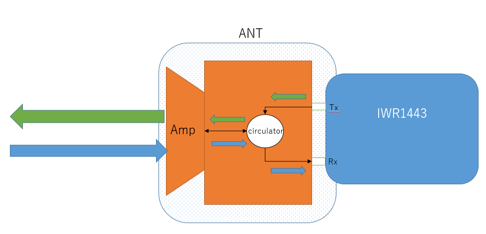

Also, it seems they would like to attach such kind of circulator with external gain amp to existing IWR1443BOOTST patch ANT to get the RF beam-formed. Do you have any experience for such use case ?

    I`m not specialist in RF, but it seems like they are considering to use the following configuration in RF part. I`m wondering if this might not be adapted to BOOST EVM directly, but might be feasible in their custom board. What do you think ?

    Another question. As I described in the picture in the previous post, my customer wants to use a waveguide (rather than patch antenna) with IWR1443. Is it possible ?
    NK
  • Hi
    Yes a circulator can work. The leakage power from Tx -> antenna -> Rx is a concern, typically that has to be at least -35db.
    The antenna to receiver has a very low loss, typically 1-2db. The Tx to antenna also should be low loss.
    The amp is not usually in the place shown.
    IWR1443 -> tx -> Amp -> Circulator -> attenuator -> External LNA -> Rx
    <->TDD Ant
