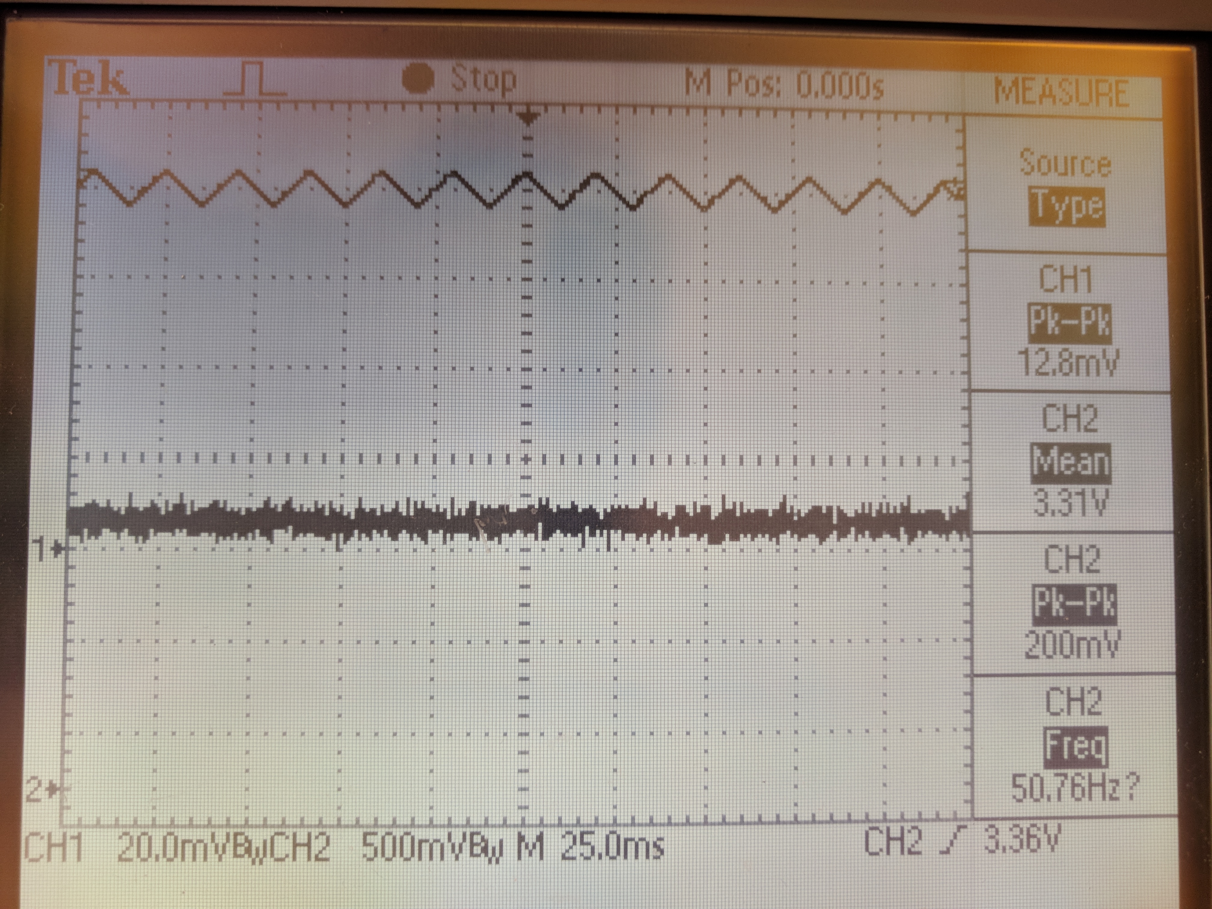

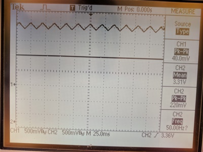

    For your reference, I measured the response of a random DRV5053 sample to a low-frequency power supply ripple waveform with no supply bypass cap, no input field and no load applied. VCC and VOUT were measured with respect to the chip GND pin. My observations are captured in the pictures below.
    CH2 depicts the VCC signal consisting of a 200mVp-p ramp @ 50-Hz fundamental, superimposed on a DC component of 3.3V driven by a clean DC power supply. With no field applied (B=0) the DRV5053 output sampled on CH1 has a DC value of 1V as expected.
    Zooming in on the AC component of the output down to 20mV/division which is below the level of variation you are observing, the output is pretty much flat. This behavior correlates with the datasheet.
