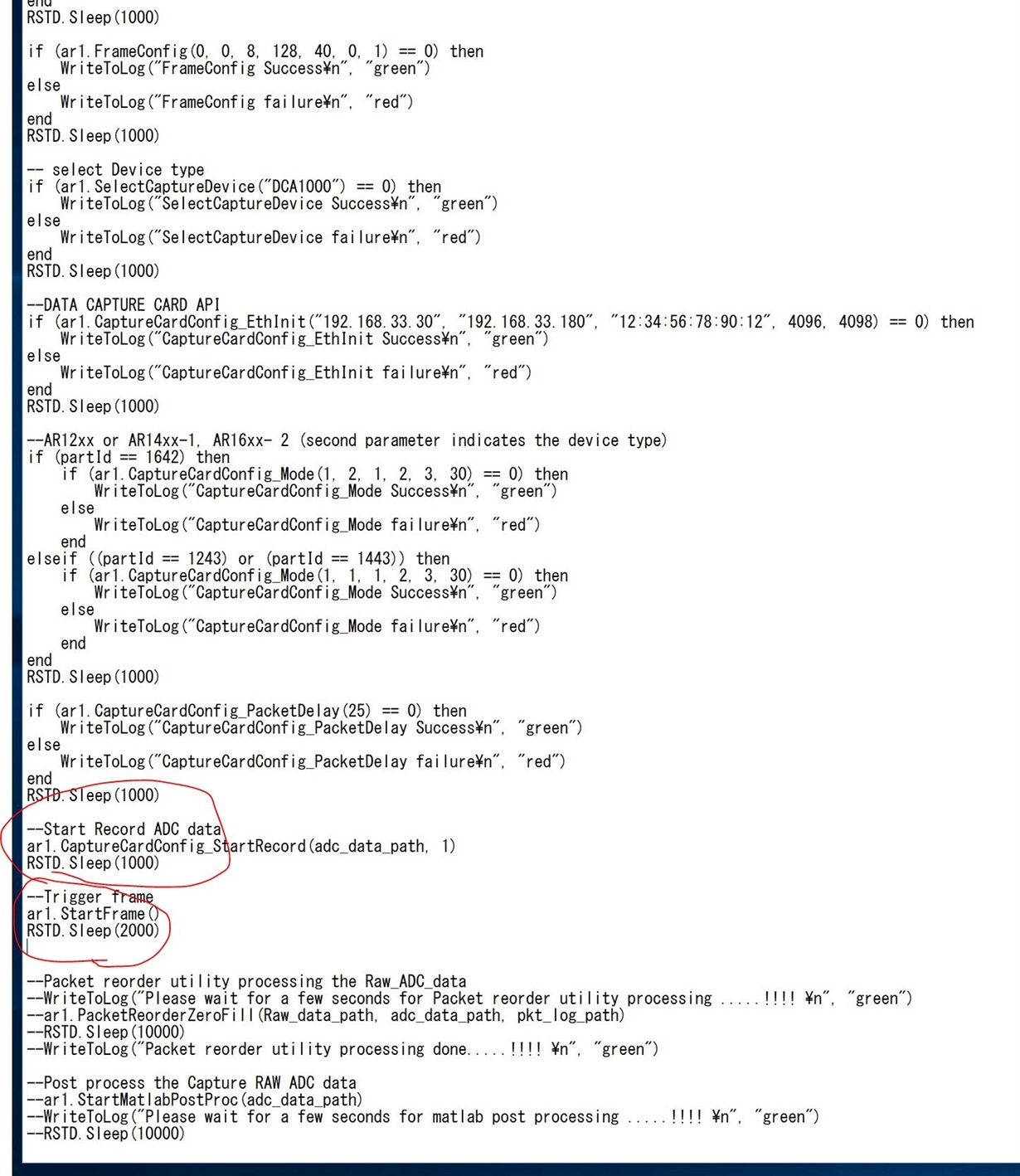

I have a customer who is using IWR1443BOOST with DCA1000EVM.
They wants to reduce data acquisition time as quick as possible.
Currently it takes ~4sec, but he wants several tens of milli-seconds.
Is this feasible?
