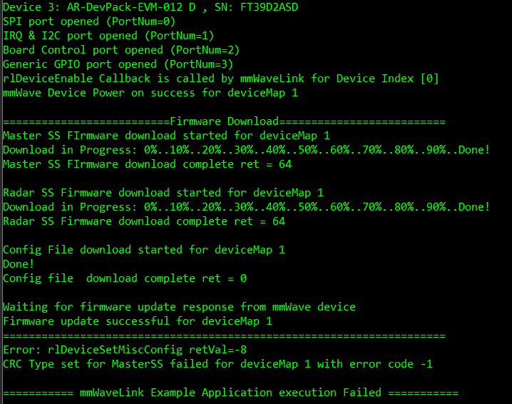

I tried to run DFP mmlink example with AWR1243BOOST+DCA (SOP set to 001 functional mode), but got the following error
Anyone knows what's the issue here?

Hi Anand,
Got it.
One more thing: the AWR1243 is set to the functional mode which is supposed to look for firmware from flash, rather than downloading from the host processor.
However, it looks like the mmwavelink example downloads firmware everytime to AWR1243, which conflicts the SOP setting of functional mode.
What's the mechanics behind this?
