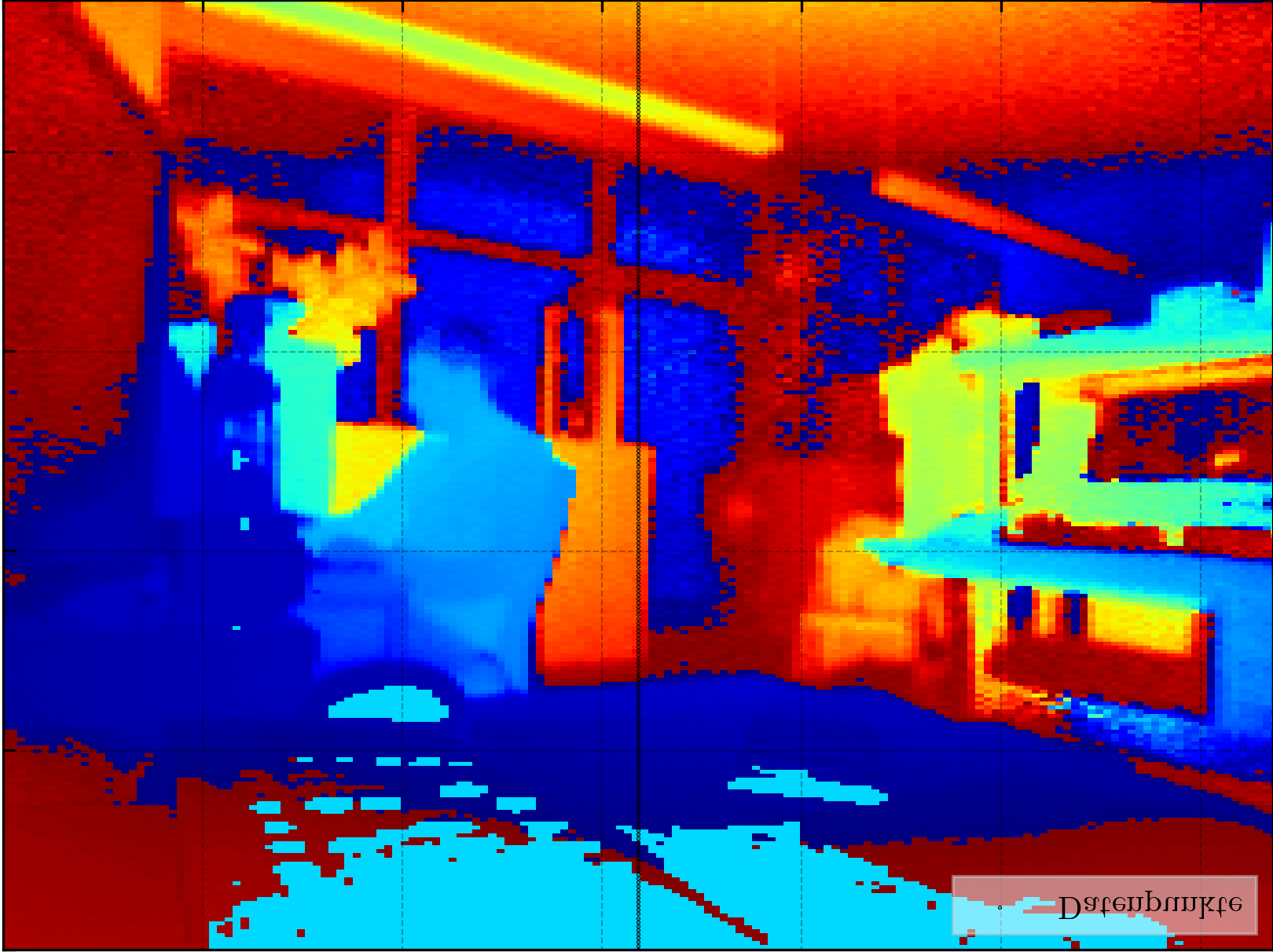

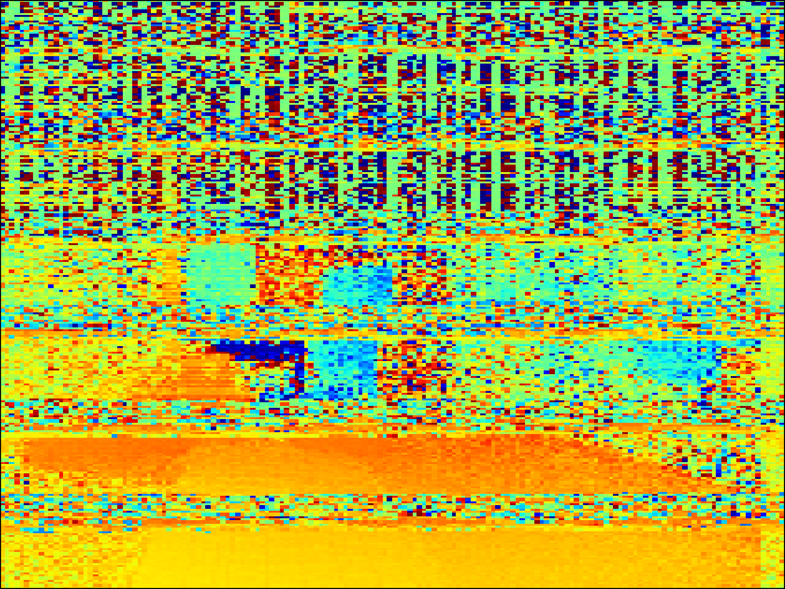

I am using the OPT8241 CDK, feeding the camera data via DCMI to an STM32 (the FX2 is disabled). Everything works fine, however I can't get the camera working in slave-mode using VD_IN. If I do, the picture looks like this:
A proper picture of the same scene using my camera settings looks like this:
I am guessing there is something going on with the integration duty cycle.
I tried different trigger times, all resulting in the same kind of error. I am using the 2-byte mode. Could this be a problem? Is there a specific time during camera setup, when the slave mode has to be enabled? Like e.g. directly after setting the IDC?

  • Hi Julian,
    1) With slave mode, register 0x181 [5:4] (0x58, 0x81 [5:4]) should be set to 0. The default value for this (masked register) is 3.
    2) Please test the camera with mac_test_en as 1. You should get expected test patterns.
    3) Could you share the register sequence you're using to set slave mode? That would be helpful in debugging the issue.
