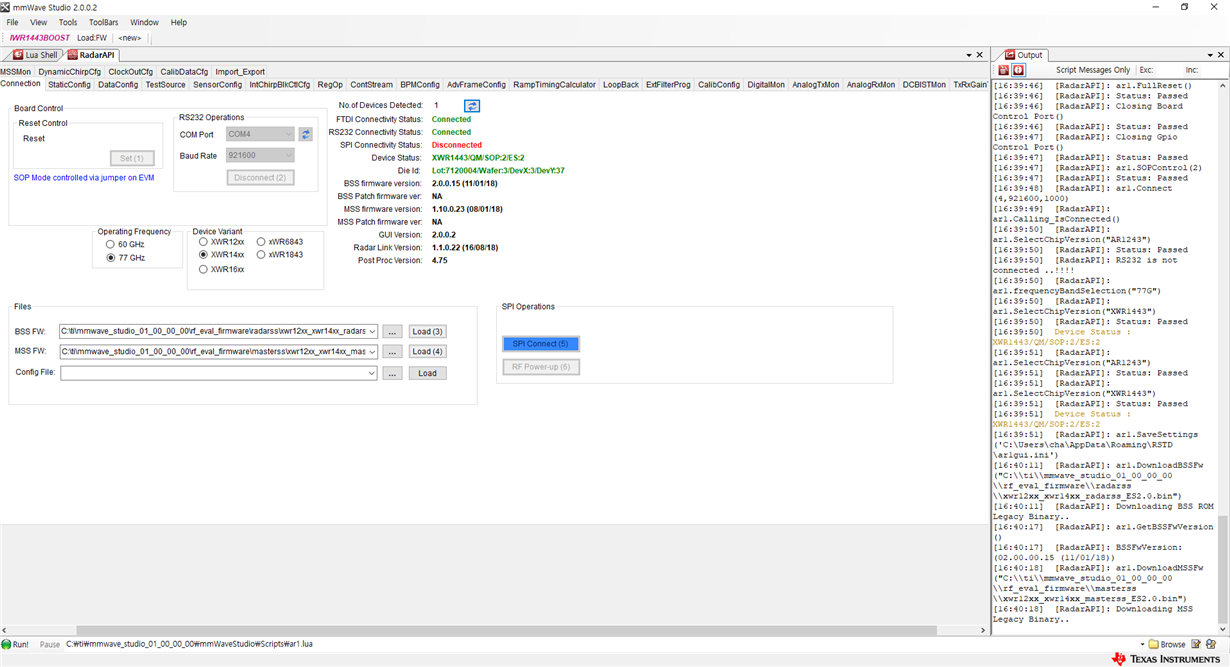

I connected IWR1443BOOST and DCA1000
I used mmWave Studio. then, I clicked SPI connect
But, Stopping without change.
I wonder if there is a way to solve it.
        It appears that you are using 2.0.0.2 mmWave studio, as per release notes, it's supports  following devices
    By looking at the log, Device seem to be IWR1443 ES2.0 silicon. It's supported on mmWave studio 1.0 version and corresponding RF eval firmware.
    Thanks and regards,
    CHETHAN KUMAR Y.B.
  • hello CHETHAN KUMAR Y.B.
    I tried using mmWave studio v1 as you said.
    But, the same thing happens.
    I used mmWave studio v2, but firmware version is v1(ES 2.0)
    It worked well to PostProcessing in mmWave Studio v2
    After using mmWave Demovisualizer, SPI connection stops in mmWave studio.
    'mmWave_studio_user_guide' 24-page, The SPI Connect button becomes SPI Disconnect indicating a success. If SPI connect does not succeed you may need to erase the serial flash and try again using the Uniflash tool.
    Do you know how to do that?
  • Hello. CHETHAN KUMAR Y.B.
    I know how to connect SPI
    Sorry.... The hardware connection wasn't working well.
