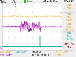

I followed the datasheet/user guide and attempted to use the provided piezo (SMD15T21R111WL), for a simple test application in air (short distance measurements). Simply, to retrieve back signals. Sadly, I was unable to receive any sensible data on the GUI (graph) or on the oscilloscope.
The setup: Piezo aimed towards the surface.
The result was as following (Orange signal = START, Purple single = COMP_IN, Blue signal = STOP)
Problem:
No matter how far the piezo's distance is towards the surface, or the angle towards the surface it would still give me the same result, no changes occur. The signal only changed when any object touched the piezo.

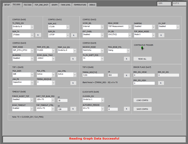

1. Loaded default configuration for the piezo

My current setup configuration:
I'd appreciate any help!

  • Hamzra,
    I see that you have received the STOP & thereby should be able to find the TOF.
    Please refer the document: www.ti.com/.../snaa266a.pdf on how to attach the transducer to get accurate results.
  • Thanks for replying ,
    Indeed, I have received the STOP signal, but the readings from the oscilloscope/the graph (GUI) do not change. So, therefore the TOF measurements are the same at all times.
    Take for example the piezo aimed towards the surface above (short distance measurement in air). Here's the scenario:
    1. If I move the piezo away from the surface, the stop signal should go more to the right, but it stays the same. So, TOF stays the same.
    2. If I move the piezo towards the surface, the stop signal should go more to the left, but it stays the same. So, TOF stays the same.
    3. The readings' only change if the piezo touches another object.
    The readings are the same at all times, what may I be doing wrong here?

  • Hamza,
    Please refresh the GUI and see if you still see the STOP pulses. If you still see the stop pulses without really transmitted from the transducer then it could be a case wherein the transducer is picking up noise and that is producing a STOP pulse.
    Try to either increase or decrease the threshold that could help to get over the noise issue.
