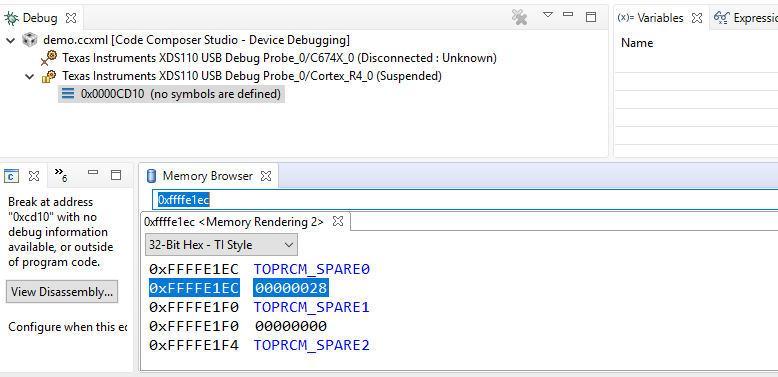

    And what is the value of 0xFFFFE1EC address? You need to look this address from MSS core connection and it should be 0x000F0028 value if ccsdebug.bin is flashed propery and BSS firmware matched.

    b. Check the value of 0xFFFFE1EC address while it is connected to MSS core, it's value should be 0x000F0028.

    b. Check the value of 0xFFFFE1EC address while it is connected to MSS core, it's value should be 0x000F0028 - No, 0xFFFFE1EC this address has 0x00000028 value, please see below attachment-

  • Hi Sonal,
    Based on this snapshot, I can say that the image (ccsdebug.bin) you have flashed is not booting up due to some reason. If it were then you should able to write on '0x0' location.
    Issue observed in the above snapshot is very unlikely but could you try these options-
    1. For AWR1642 ES2.0, LTS version of mmWave SDK is 2.1, so better to move to this version.
    2. Flash the mmw demo from SDK 2.1 to device using Uniflash and check if that boots up in functional mode (Only SOP2 jumper), or check those registers' value.
