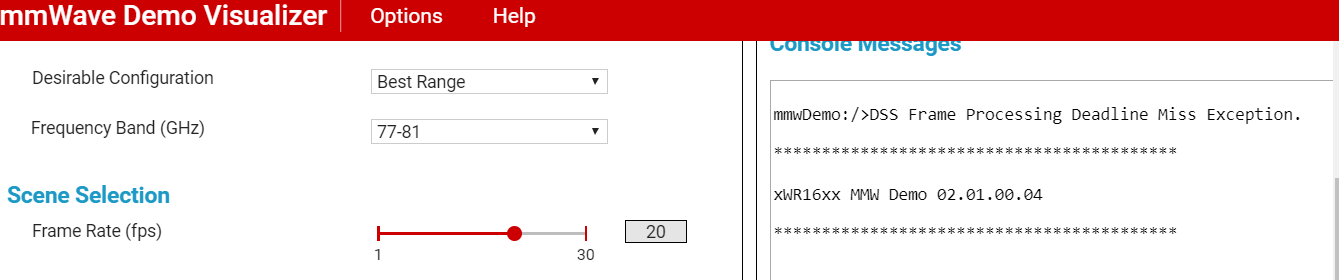

  • It appears the OOB demo found inside SDK 2.1 folder has been built with SDK 2.1. I infer this from the following reasons.
    See attached images
    1. When the board was delivered it had a 2.0 Version of OOB demo
    When I tried to configure the board using the demovisualizer, I had to choose SDK 2.0 it will not allow me to choose SDK 2.1 - it will complain target board SDK is different.
    2. I have now reflashed the board with the bin file found inside SDK 2.1
    When I try to use the demo visualizer, I can no longer choose SDK 2.0, I have to choose SDK 2.1 .
    So the OOB demo CAN be built with SDK 2.1, please advise how.
