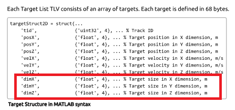

1. target info about accX/accY/accZ are assigned with dimension info (ex:targetList->target[n].accX = targetDescr[n].dim[0];)
2. No elements in MmwDemo_output_message_target struct to store dimensions info:depth, width, [height], doppler
3. However, TLV still have the output data for dimx/dimy/dimz

For the document -Overhead_People_Tracking_and_Stance_Detection_users_guide.pdf, it says dimx/dimy/dimz are the target size in x/y/z dimension.
Seems need to update overhead People Counting Demo sample code for such issue..
