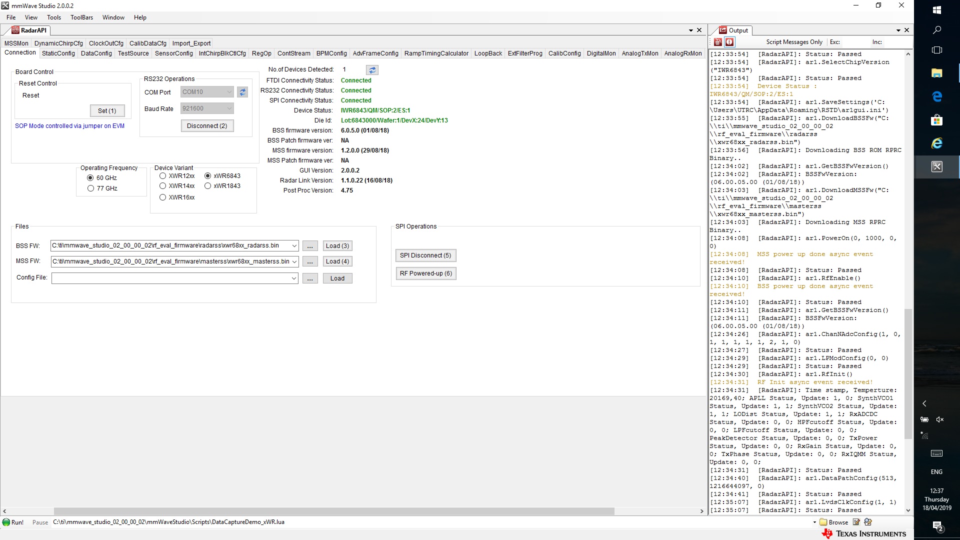

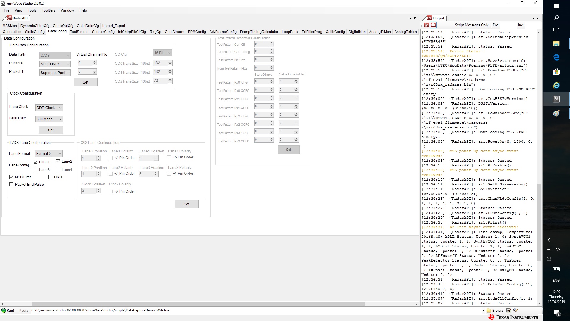

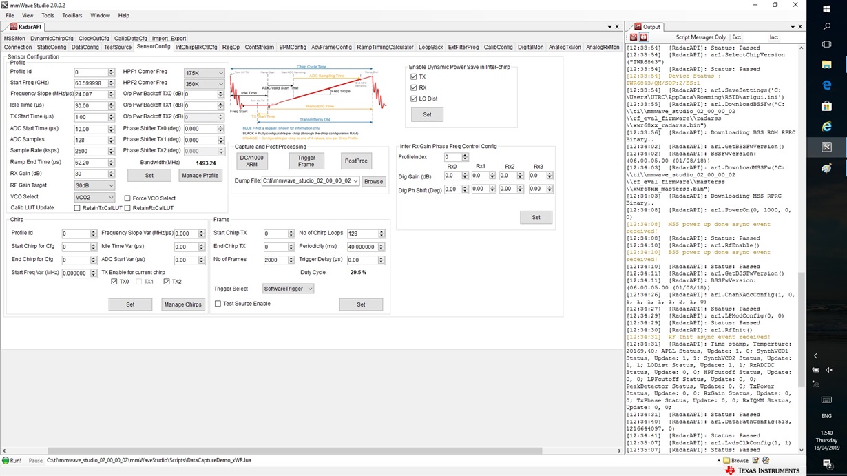

Hi:
By following the section "Capturing Raw ADC Data" of the "mmwave_studio_user_guide.pdf" document, I have been able to use mmWaveStudio to capture raw ADC data using two transmitters (e.g., Tx0, Tx2) and all four receivers.  I have also managed to read all the data of the 8 virtual channels. But when I apply the Capon algorithm to generate the range-azimuth heatmap, for the 8 virtual data, I do not get the heatmaps correctly. However, for applying the Capon algorithm to the first 4 channel data, I get meaningful and correct heatmaps displaying movement of the people in range-azimuth over time. This suggests that some extra step needs to apply to the 5th - 8th virtual channel data. Could you tell me what I am missing here?
Many thanks.
Ziyou

  • Hi, Ziyou:
    It is very likely that you will need to run the phase offset calibration to align the phase offset between different TX/RX pair.
    Refer to the section "Range Bias and Rx Channel Gain/Offset Measurement and Compensation" in the doxygen documentation at: C:/ti/mmwave_sdk_03_01_01_02/packages/ti/demo/xwr68xx/mmw/docs/doxygen/html/index.html
    You can easily run the gain/phase calibration through visualizer GUI. Here are the steps:
    1) Set the target as explained in the demo documentation and update the mmwave_sdk_<ver>\packages\ti\demo\<platform>\mmw\profi appropriately.les\profile_calibration.cfg
    2) Set up Visualizer and mmW demo as mentioned in the section . Running the Demos Use the "Load Config From PC and Send" button on plots tab to send the mmwave_sdk_<ver>\packages\ti\demo\<platform>\mmw\pr ofiles\profile_calibration.cfg.
    3) The Console messages window on the Configure tab will dump the "compRangeBiasAndRxChanPhase" command to be used for subsequent runs where compensation is desired.
    4) Copy and save the string for that particular mmWave sensor to your PC. You can use it in the "Advanced config" tab in the Visualizer and tune any running profile in real time. Alternatively, you can add this to your custom profile configs and use it via the "Load Config From PC and Send" button.
    You can also use this result to apply in your post processing for your DCA captured data. Here is a quick example of what you get from visualizer.
    compRangeBiasAndRxChanPhase 0.0571678 0.59717 0.59137 0.22586 0.76904 -0.06100 0.67480 -0.03009 0.72189 0.72018 0.10983 0.65768 0.39835 0.38239 0.65680 0.43262 0.72324 0.88715 0.13147 0.80719 0.55542 0.26929 0.96307 0.17258 0.86649
    Then, you can use the vector as below
    >> a = [0.59717 0.59137 0.22586 0.76904 -0.06100 0.67480 -0.03009 0.72189 0.72018 0.10983 0.65768 0.39835 0.38239 0.65680 0.43262 0.72324 0.88715 0.13147 0.80719 0.55542 0.26929 0.96307 0.17258 0.86649];
    >> phaseRot = [a(1:2:end) + 1j*a(2:2:end)].‘;
    >> X_comp = X.* phaseRot; % actual compensation, assume X is the DOA input.
    Zigang

    Let me show you the settings I specified on the mmwave_studio_02_00_00_02 GUI:
    The first picture shows "all connections are OK".
    The second picture shows that I choose Tx0 and Tx2. Also I specify "Complex1x" under "ADC Config -> Format".
    The third picture shows all the "default" option after I made the choices in the second picture. Note that "Lane 3" and "Lane 4" are automatically grayed out so I could not change those.
    The fourth picture has the "profile" parameters I specify. Note that I have also checked "Tx0" and "Tx2" at the lower-left of the picture.
    These are all the choices I've made. Then after I have captured data by clicking "Trigger Frame", I click "PostProc" to get the "*.bin" file. I then wrote some Matlab script to get the data in order.
    What could have been wrong?

  • Your configuration is not setup for TDM-MIMO. The enabling of both tx-es in the last picture indicates that in every single chirp you are enabling both Tx0 and Tx2 (simultaneous) transmissions which is the reason why your data is essentially looking the same from one chirp to next [between the two groups of 4 rxes]. You need to setup to chirp alternatively with only Tx0 active in even chirps and only Tx2 active in odd chirps. You need to understand the meaning/relationship among chirp configuration, profile and frame configuration in order to be able to do this correctly. The following thread may help: http://e2e.ti.com/support/sensors/f/1023/p/624663/2312421?tisearch=e2e-sitesearch&keymatch=mmwave%20studio%20tdm%20mimo#2312421
  • Piyush_:
    Thank you very much for this clarification. I am able to follow the instructions and got the 8 virtual channels to work.
