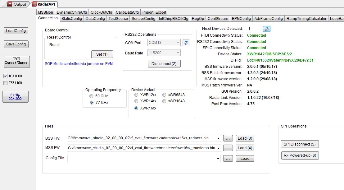

[14:48:01] [RadarAPI]: ar1.Connect(18,115200,1000)
[14:48:02] [RadarAPI]: ar1.Calling_IsConnected()
[14:48:03] [RadarAPI]: ar1.SelectChipVersion("AR1642")
[14:48:03] [RadarAPI]: Status: Passed
[14:48:03] [RadarAPI]: RS232 is not connected ..!!!!
[14:48:03] [RadarAPI]: ar1.frequencyBandSelection("77G")
[14:48:03] [RadarAPI]: ar1.SelectChipVersion("XWR1642")
[14:48:03] Device Status : XWR1642/QM/SOP:2/ES:2
[14:48:04] [RadarAPI]: ar1.SelectChipVersion("AR1642")
[14:48:04] [RadarAPI]: Status: Passed
[14:48:04] [RadarAPI]: ar1.SelectChipVersion("XWR1642")
[14:48:04] Device Status : XWR1642/QM/SOP:2/ES:2

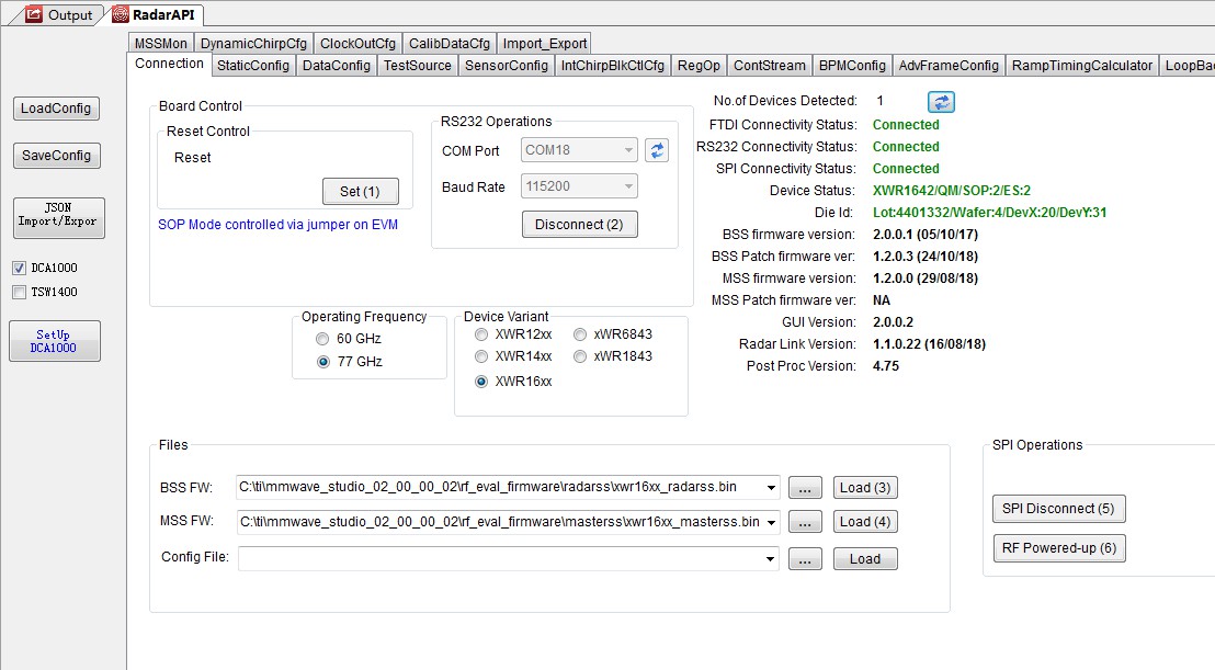

[14:48:05] [RadarAPI]: ar1.SaveSettings('C:\Users\LENO\AppData\Roaming\RSTD\ar1gui.ini')
[14:48:07] [RadarAPI]: ar1.DownloadBSSFw("C:\\ti\\mmwave_studio_02_00_00_02\\rf_eval_firmware\\radarss\\xwr16xx_radarss.bin")
[14:48:07] [RadarAPI]: Downloading BSS Patch RPRC Binary..
[14:48:14] [RadarAPI]: ar1.GetBSSFwVersion()
[14:48:14] [RadarAPI]: BSSFwVersion:(02.00.00.01 (05/10/17))
[14:48:15] [RadarAPI]: ar1.GetBSSPatchFwVersion()
[14:48:15] [RadarAPI]: BSSPatchFwVersion:(01.02.00.03 (24/10/18))
[14:48:15] [RadarAPI]: ar1.DownloadMSSFw("C:\\ti\\mmwave_studio_02_00_00_02\\rf_eval_firmware\\masterss\\xwr16xx_masterss.bin")
[14:48:16] [RadarAPI]: Downloading MSS RPRC Binary..
[14:53:02] [RadarAPI]: ar1.PowerOn(0, 1000, 0, 0)
[14:53:02] [RadarAPI]: Status: Passed
[14:53:02] MSS power up done async event received!
[14:53:03] [RadarAPI]: ar1.RfEnable()
[14:53:03] BSS power up done async event received!
[14:53:03] [RadarAPI]: Status: Passed
[14:53:04] [RadarAPI]: ar1.GetBSSFwVersion()
[14:53:04] [RadarAPI]: BSSFwVersion:(02.00.00.01 (05/10/17))
[14:53:05] [RadarAPI]: ar1.GetBSSPatchFwVersion()
[14:53:05] [RadarAPI]: BSSPatchFwVersion:(01.02.00.03 (24/10/18))

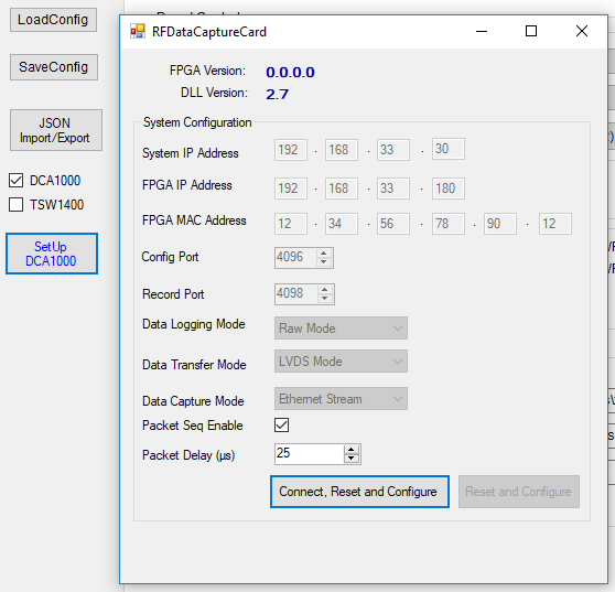

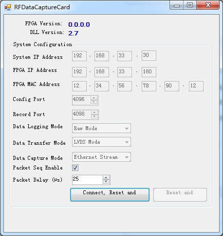

[14:54:03] [RadarAPI]: ar1.CaptureCardConfig_EthInit("192.168.33.30", "192.168.33.180", "12:34:56:78:90:12", 4096, 4098)
[14:54:05] ConnectRFDCCard Status: RRFDCCARD_SUCCESS
[14:54:05] Ethernet Cable is disconnected Please check.....!!!
[15:14:36] [RadarAPI]: StatusDCCard Event Registered
[15:14:36] [RadarAPI]: Status: Passed
[15:14:36] [RadarAPI]: ar1.CaptureCardConfig_EthInit("192.168.33.30", "192.168.33.180", "12:34:56:78:90:12", 4096, 4098)
[15:14:38] ConnectRFDCCard Status: RFDCCARD_UDP_WRITE_ERR
[15:14:38] Ethernet Cable is disconnected Please check.....!!!

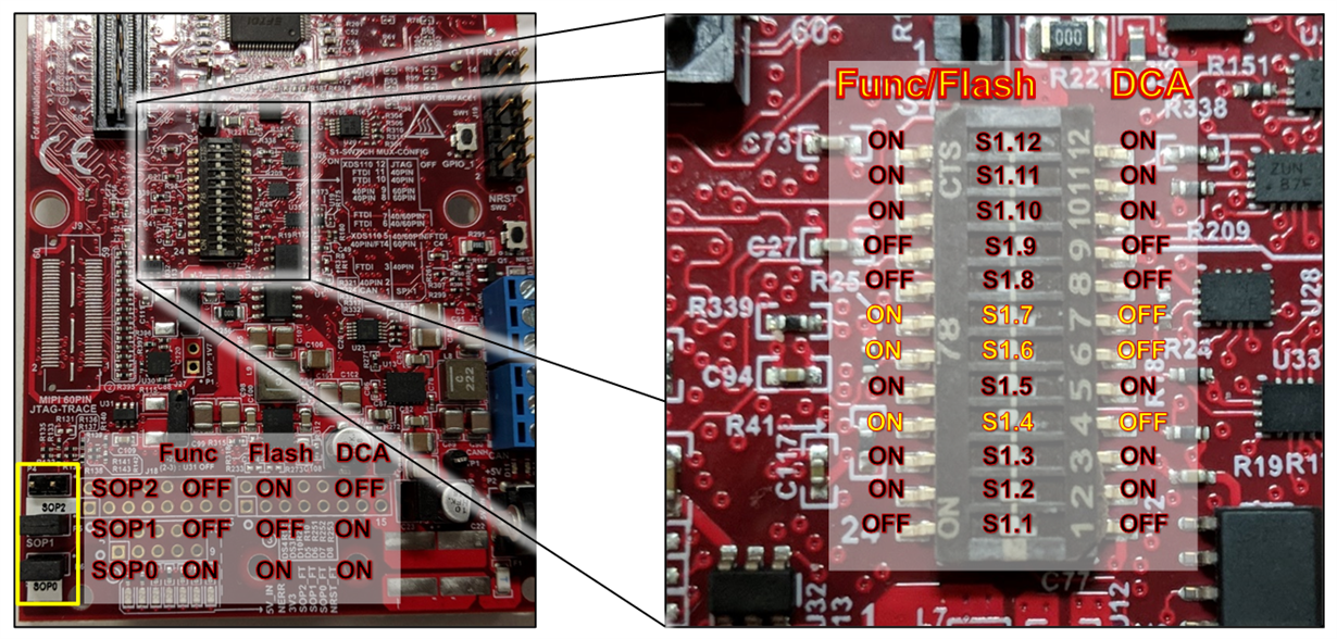

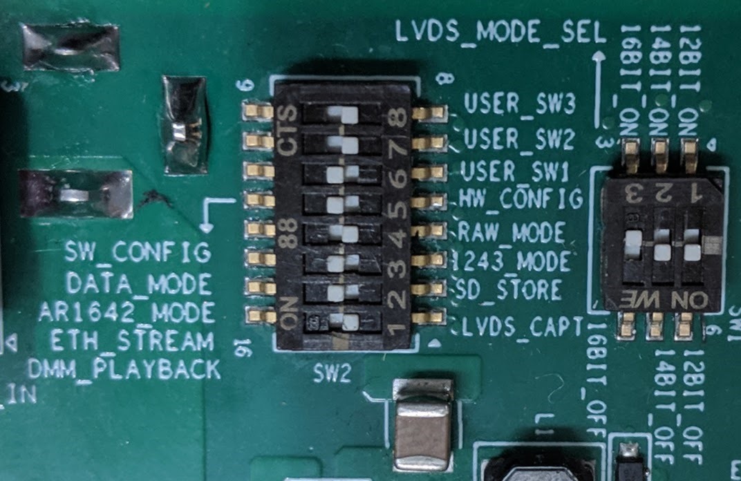

    1) Make sure your boards are set to DCA mode by placing the SOP jumpers and muxs in the following configurations.  Be sure to power cycle after changing the SOP jumper positions.
    2) Make sure you correctly set the IP address such that it matches the image below when you click 'set up DCA1000' in mmWave studio.
