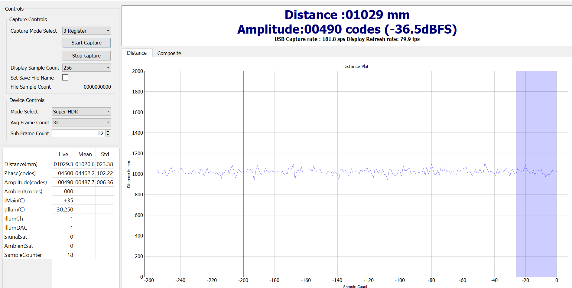

Hi
We are testing OPT3101EVM.
We want to count persons going through entrance door. Sensor could be mounted in 2.2m height on top of the door and measure distance in to zones.
I see OPT3101 cannot measure distance to carpet type of coating. In real 1.1meter distance Amplitude  is -32dBFS and measured distance is wrong.
I worry it will be the same problem if person is coming with hood or cap at winter time?
Is it posible to solve this problem?
Vaidas
