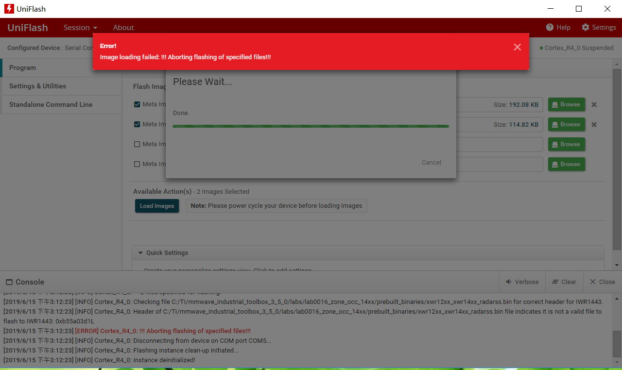

A: hi,
What's wrong with the Demo image of FLASH IWR1443 when I use the Uniflash download tool?
I tried many times, but failed. What caused it?

The board requires Reset before flashing. Can you confirm you are hitting reset before flashing?

Yes,I am sure I have pushed reset.I can erase the flash,but I can't load image either. Thanks.
What SDK version are you using? and What version of the chip (ES1, ES2 or ES3) ?
