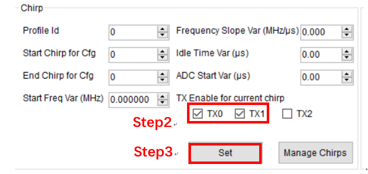

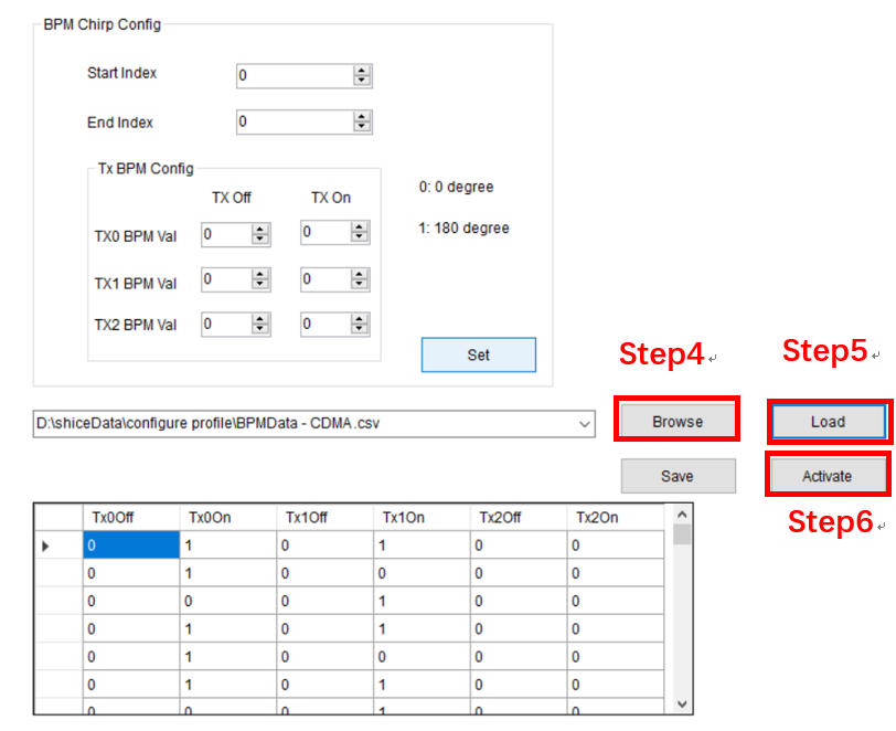

I  have some problems about Separating the waveform signals from two transmitting antenna and configuring CDMA.
Firstly,I try to separate superimposed echo signal through  Doppler FFT .I want to know if this method of signal processing is right?
Secondly,I want to know if CDMA configuration process is correct?
