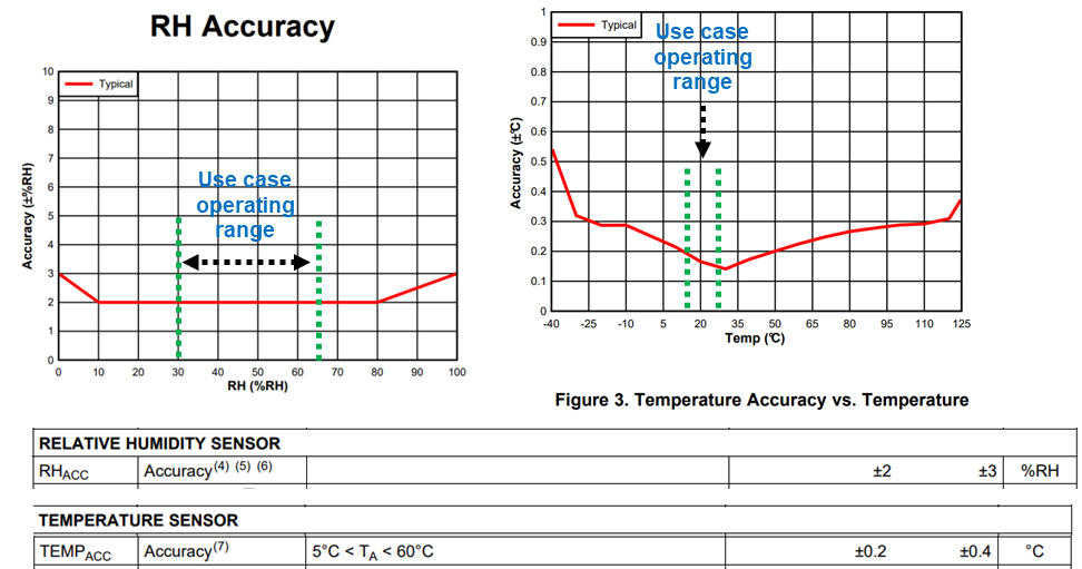

    Yes, the humidity sensor can be used from 0% to 100%RH (non-condensing conditions) and the temp sensor
    the accuracy of the humidity sensor is specified from 0C to 60C, in a 20% to 80%RH (non-condensing) environment.
    The temp sensor can be used for -40C to 125C, the tight accuracy or center point of it is between 5C and 60C. You can see whole range here on page 6 (Figure 3)
    Does the application involve range of human comfort with respect to temperature and humidity? (this would be end product operating in >30%RH to <60%RH and within ~16°C to ~28°C environment) See image below for what that means if we apply this (what i think is common) use case range to specs of device. Does this help you?
