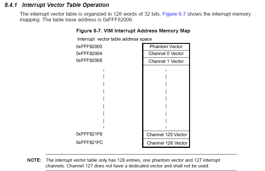

The Interrupt Vector addresses details for specific CAN Channels for DCAN of AWR1642Boost R4F ARM processor is not present in the Controller and Device data sheets provided along.
Attached below is the snapshot of the Interrupt Vector Table available in the Controller data sheet
Can you please let me know those Vector addresses for these CAN Channels.
Sagar Bhaktavatsala
    Please read more about the operation of a Vectored Interrupt Controller. Peripheral Interrupts are not directly mapped to the Vector Table.
    We provide as part of the mmWave SDK a driver to program the interrupts.
    Please review the CANFD unit test example that shows how CANFD interrupts are programmed
    C:\ti\mmwave_sdk_03_02_00_04\packages\ti\drivers\canfd\test\xwr16xx
