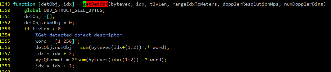

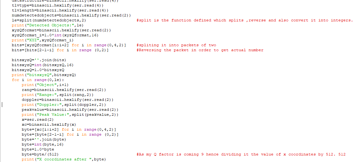

Sir,
I am working on mmwave IWR1443 ,sdk version 1.2.0.5 and currently running mmwave demo mmw_mss_14xx.I am getting 9 as a Qformat but if I am doing the calculation to find out actual x coordinates in meters by reversing the data packet coming and applying the formula ACTUAL=x coordinates/512  I am not gettong the data .Is there any condition before calculation on x coordinates.
And , does the Q format every time change because I am not able to find range resolution also.
Thanks.
