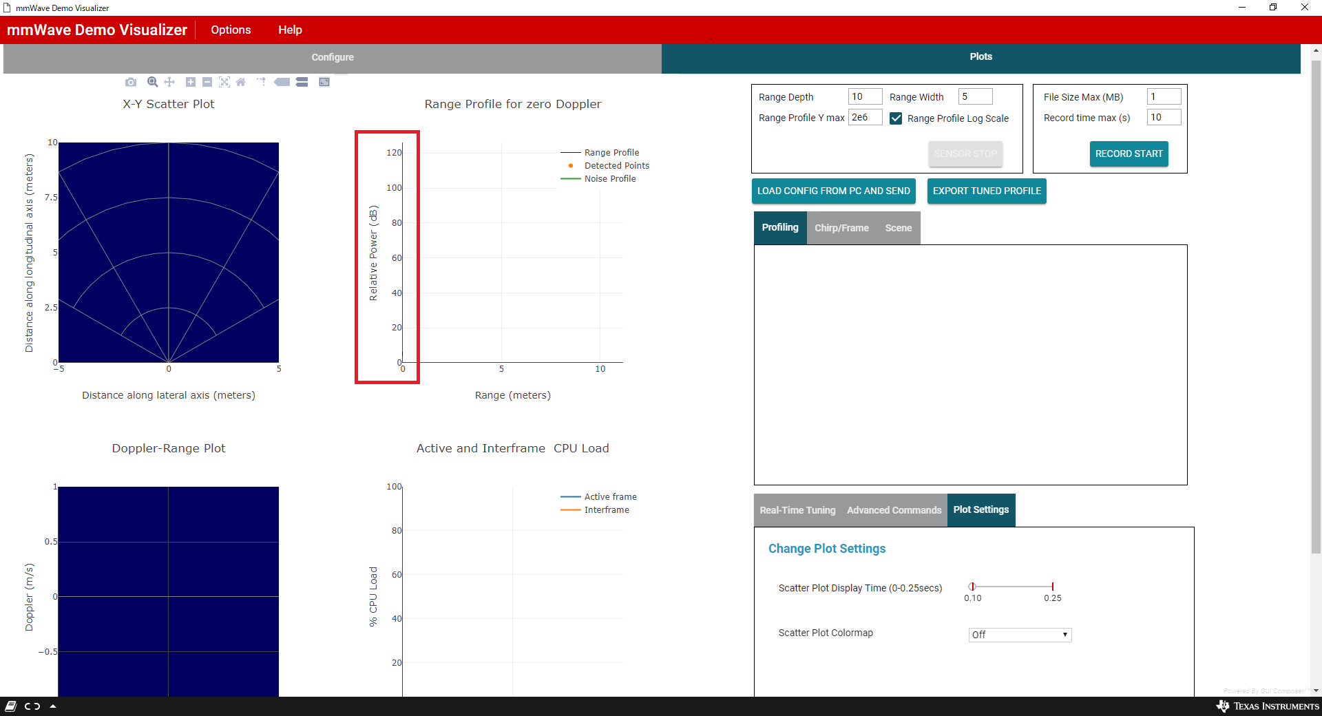

I would like to know how to calcurate "Relative Power".
It's is vertical axis of graph "Range Profile for zero Doppler" of mmWave Demo Visualizer.
I thought it was representing it with "20 * log10(value)", is it not?

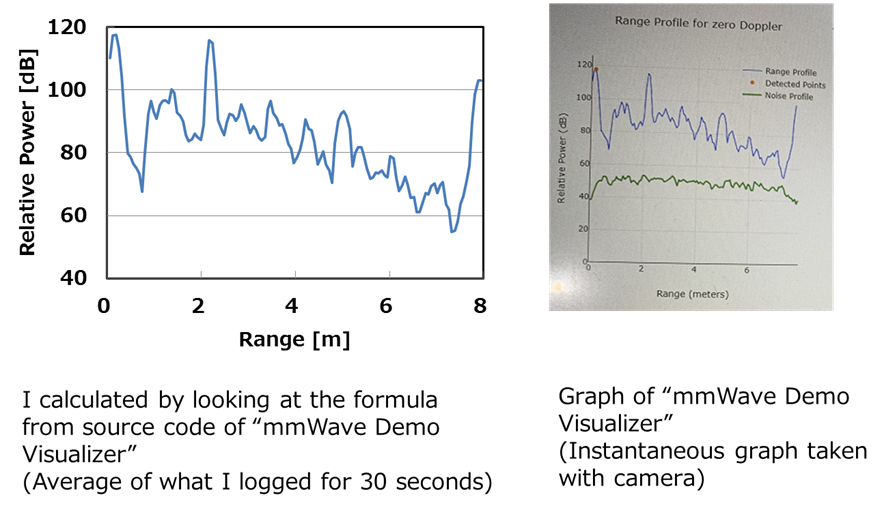

    As shown below, The graph on the left is what I calculated based  the source code, and the graph on the right is that DemoVisualizer is displaying.
    (The left is an average of 30 seconds, so it does not look exactly the same)
    Generally I think that the calculation is correct, but I can not understand the meaning of the expression written in the source code.

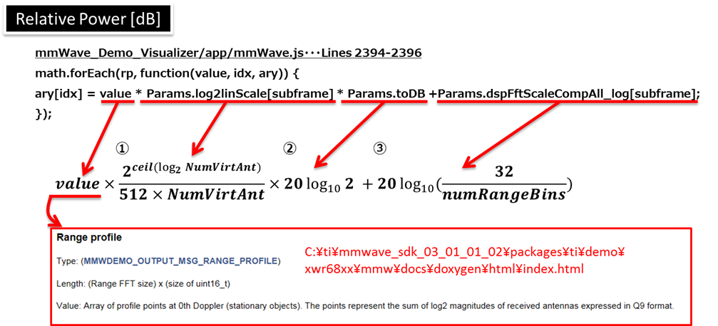

    IWR1642: [SDK message output] How to form peakVal to relative power (dB)I
    What is Params.log2linScale[subframe] ?
    What is Params.toDB ?
    What is Params.dspFftScaleCompAll_log[subframe] ?
    Best Regards

  • Hello Takeo-san,
    These parameters are calculated in the file input_validation.js, based on the device type in function parseCfg()
    	    if ((platform == mmwInput.Platform.xWR14xx) ||
                    (platform == mmwInput.Platform.xWR18xx) ||
                    (platform == mmwInput.Platform.xWR68xx))
    		P.log2linScale[idx] = 1 / 512;
    		if (P.dataPath[idx].numTxElevAnt == 1) P.log2linScale[idx] = P.log2linScale[idx] * 4 / 3; //MMWSDK-439
                else if (platform == mmwInput.Platform.xWR16xx)
    		P.log2linScale[idx] = 1 / (256 * P.dataPath[idx].numRxAnt * P.dataPath[idx].numTxAnt);
    	    P.toDB = 20 * Math.log10(2);
    I'll need to check and get back to you on the details behind the calculations for the specific scaling factors.

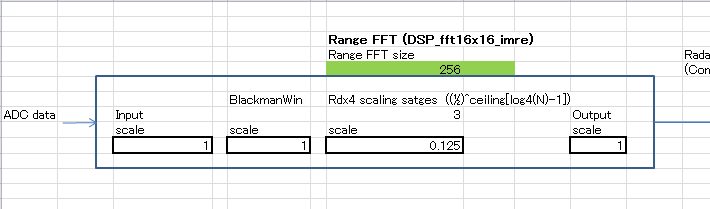

    2. mmWave SDK 3.2.0.4 includes a .xls file as given below, which explains the scaling operations performed at each stage of mmWaveDemoProcessing. Note that the scaling is different for HWA and DSP based detection chains and correspondingly, there are two tabs in the spreadsheet. Please refer to the DSP tab for the ODS demo.
    C:\ti\mmwave_sdk_03_02_00_04\packages\ti\datapath\dpc\objectdetection\common\docs\object_detection_data_scaling.xlsx
    -Nitin
  • Dear Nitin
    Sorry for the late reply.
    I don't understand how the source code is related to the object_detection_data_scaling.xlsx file.
    For example, DSP range FFT uses 4 scales(Input, BlackmanWinm Rdx4 scaling satges, Output).
    How does it relate to "Params.log2linScale[subframe]", "Params.toDB", "Params.dspFftScaleCompAll_log[subframe]" of source code?

    I burned SDK demo FW (ti\mmwave_sdk_03_02_00_04\packages\ti\demo\xwr68xx\mmwxwr68xx_mmw_demo.bin)
    to IWR6843-ODS and evaluated with DemoVisualizer(ver 3.2).
    In this case, calculate 20 * log10 (peakVal) from the rangeProfile data (peakVal)  that is obtained from the serial,
    ignore the graph displayed in DemoVisualizer.
    Is this perception correct?
    Then, colud I get  only relative output and not absolute output value from rangeProfile?
