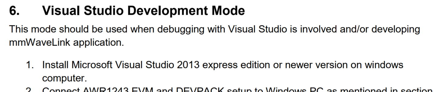

Problem 2:
I read dpf's user guide, it said I can use a newer visual studio version than vs2013 express edition.
I don't install vs2013 and open mmwavelink_example in dpf1.2.5 by VS2019 community(windows sdk is 10.0 not 8.1 and toolset is v142).
BTW, I upgrade windows sdk and toolset.
Then I find I can't build this solution successfully, here are the error log:
I try to google it, but still can't solve with it.
So whether I have to install vs2013 to build it, or there are somethings I missed?
