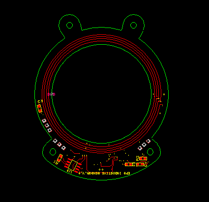

    I hope you can see the coils from the below snapshot Fig 2. I have chosen the circular coil and it is one layer. We don’t need to have high inductance in our application since the coil diameter is larger one.
    1.     What is the size of your target? What is the material? How close is the target to the coil? – I also have attached the target wheel image in this Fig1. Dia-60mm ; Thickness-1mm. Material- Mild Steel.
    2.     How have you connected your coil to your LDC1101? Typically coils need a minimum of two layers in order to route both ends of the coil to the LDC1101. Are you using wires? Yes. I am using LDC1101 but I have used only one layer which is 4 no of Turns. I have attached those image as well in this. One Layer – 4 Turns

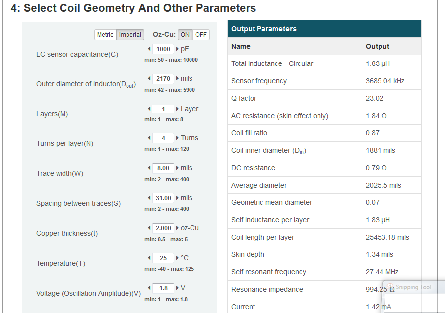

    I have extracted this output parameters as based on my coil design.
  • Hello Muthu,
    My apologies for the delayed reply. Can you clarify if the boxes in your target are cutouts? This would make the target much more difficult for the LDC to detect. The target should be smooth without gaps or cutouts, which disturb the path of the eddy currents that flow on the surface. In addition, if your target is too far from the sensor then the LDC will have trouble detecting it. For an ideal target (no gaps, highly conductive, and at least as large as the coil), the maximum sensing distance of the LDC1101 is ~100% of the sensor's outer diameter.

    Thanks for your feed back.I have made one spiral coil with the same diameter  at externally with same dia of 53mm (Coil made manually with 28gauge wire) and found ok with desired result .
