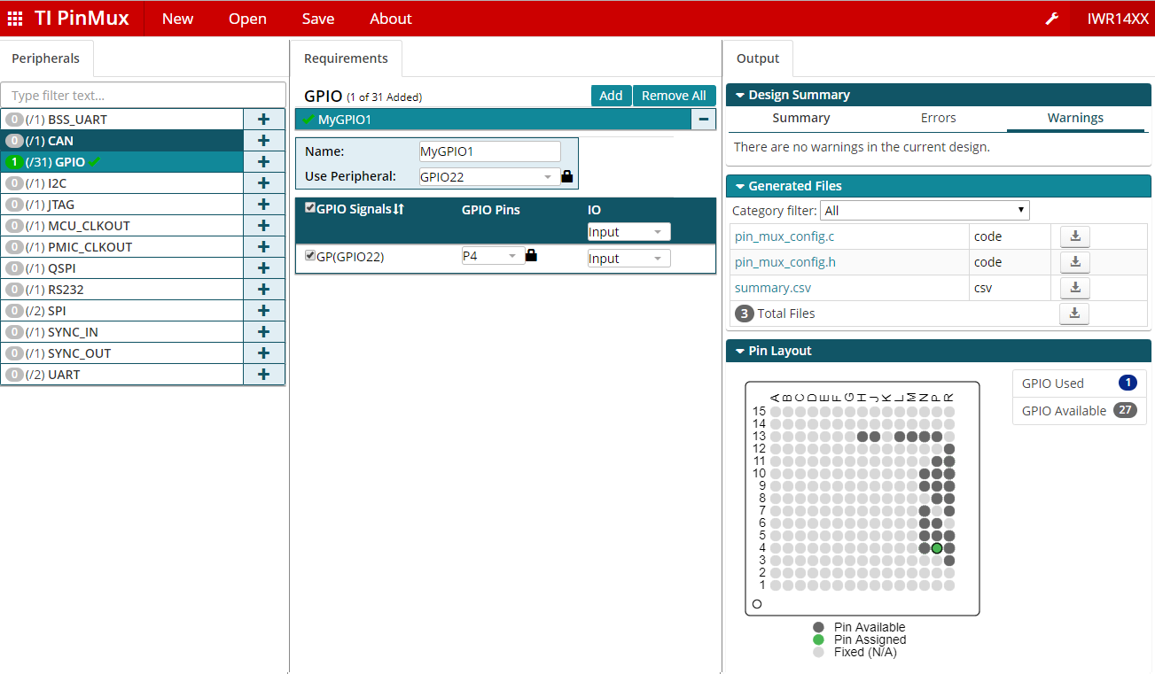

Is pull control of GIO possible with IWR1443?
GIOPULDIS and GIOPSL registers of the following GIO pins
I switched, but the register settings are not reflected.
GIO_1(pin#N7,input) (GIOPULDIS,GIOPSL)=(0,1)
GIO_2(pin#N13,input) (GIOPULDIS,GIOPSL)=(0,1)
GIO_4(pin#R4,input) (GIOPULDIS,GIOPSL)=(0,0)
GIO_22(pin#P4,input) (GIOPULDIS,GIOPSL)=(0,0)

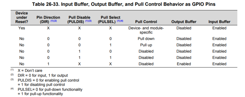

In swru522d.pdf, the following is described in section 17.3.1.
Does IWR1443 support GIO pull control?
swru522d.pdf 17.3.1:
Some devices may not support the programmable pull controls. In that case, the pull
disable and the pull select register controls will not work.
