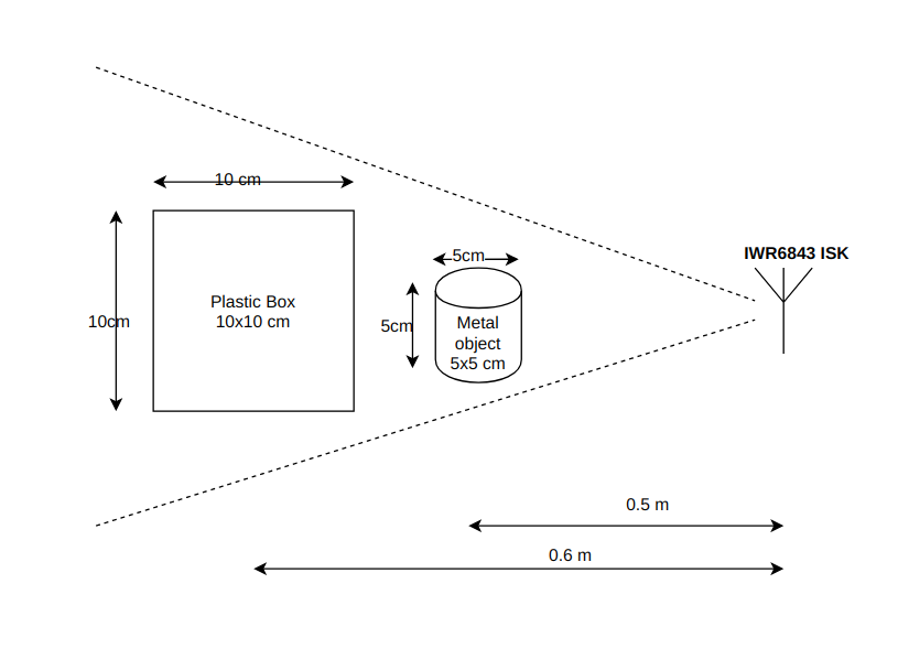

Can IWR6843 ISK detect multiple objects of different material which are behind each other as shown in the figure at 0.5 mtr distance?
Would this detection possible in the python GUI application provided by the TI?
Keen to learn your thoughts about such application.
Would like to know the demo application and chirp configuration suitable for this application.
  • Dear Sudharshan:
    Based on the dimensions of the set up your application will need focus on range resolution. Range resolution denotes the minimum distance that two objects can be resolved as two separate objects and not just one object. In your case the metal object and the plastic box are separated by 10 cm. So make sure that when configuring the device that the range resolution does not exceed the distance between the two objects in the scene.

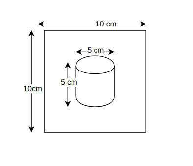

    In the above application, the metal object and plastic box are behind each other when we look it from the antenna end. Ideally from radar perspective, the two objects looks like as shown below,
    Sudharshan

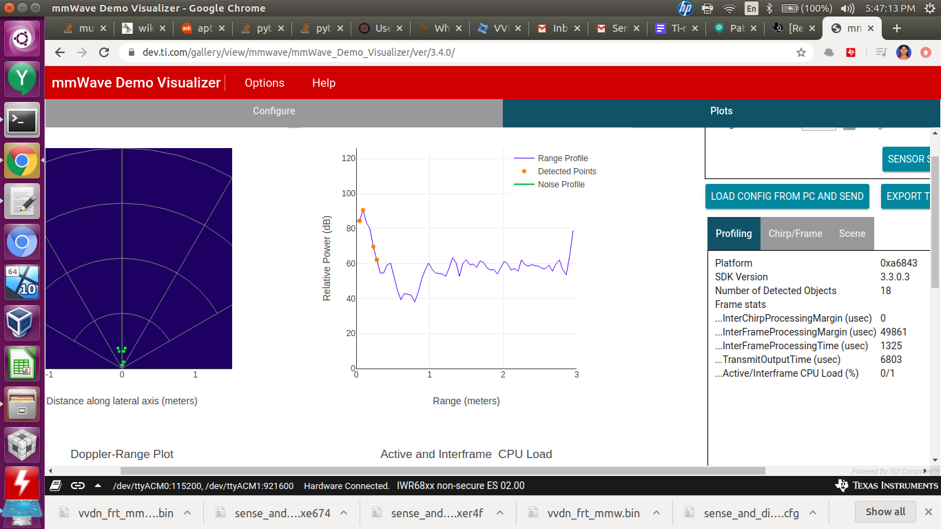

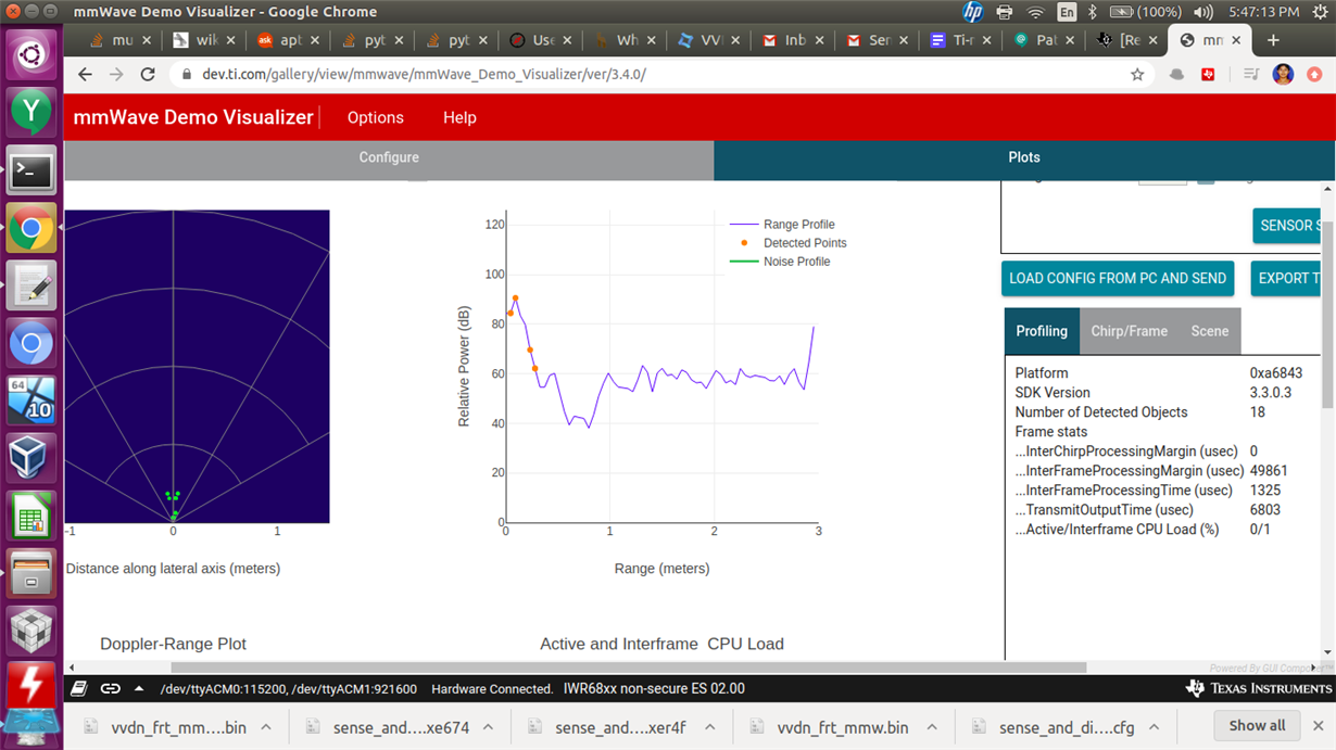

  • Hi Connor,
    As per your suggestions, I flashed out-of the box demo for checking the output. As i observed that , if i disable the "static clutter removal" and  "peak grouping in range and doppler" option, i could see more number of detected objects even if no object is present in front of the RADAR. But when i enable that option, the number of detected objects reduced.
    The following image is for the no object case when the options were disabled :
    As in image we can see the Number of detected objects field is showing 18 and it will be varied frequently.
    Could you please assist me regarding this?
    Please suggest your thoughts
    Thank you
    Shraddha
  • Shraddha:
    I would suggest reading more about the CFAR configuration and chirp configuration. Then apply changes and record the differences on what you see in the scene. From viewing other scenes that pertain to static object detection the disabling the static clutter removal is needed. I am not absolutely sure but the variance of the number of detected objects could be reduced for your scene by tinkering with the CFAR and Chirp configurations.
