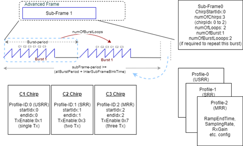

    For your usecase: chirp1 USRR, chirp2-SRR,chirp3-MRR all within a single burst.
    For this purpose, each chirp needs to connect with different profile configuration. [profile-0: USRR, profile-1: SRR, profile-2: MRR]
    mmwave sensor currently supports max of 4 profile configuration. So within burst/frame you can configure three set of chirps to three different profile-ID then repeat these three chirp set multiple times (if required) within burst/frame.
    As you see in the above snapshot, each chirp RAM has a field of profile-Idx with which it needs to connect or get other configuration (numOfSample, chirp duration, freq start, sampling rate etc.)
    Thus, your requirement to have each chirp different within a burst/frame is possible with mmwave sensor.
    In RadarSS all the configuration are stored in RAM and it configures the HW in a group of chirps (no. of chirps in this group may vary based on time available or total no. of chirp in busrt/frame).
    Dynamic update I have mentioned above if you need to change any existing configuration for the next frame then that can be done using dynamic APIs.

    As I understood your usecase that you need 3 different types (USRR, SRR, MRR) of chirp within the same frame/burst then that is possible with single shot configuration without using dynamic reconfiguration.
    I hope below picture clarify your doubt.
