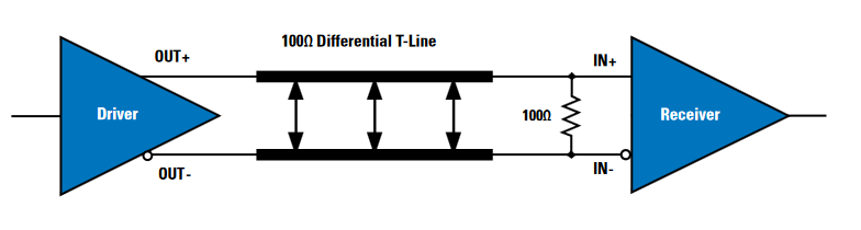

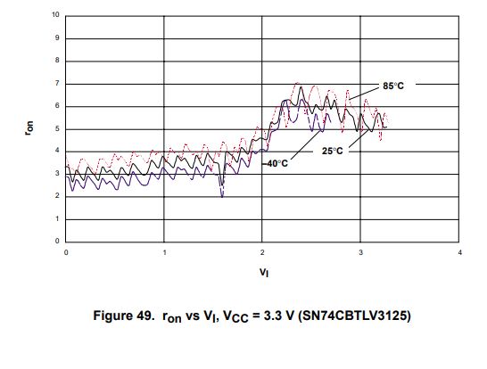

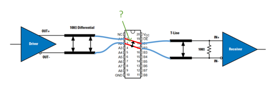

  • Hi Adam, It seems the Impedance changes with the voltage for example with a VCC of 3.3V and an input voltage of 2.4V, and a current of 15mA I see a typical Ron of 10ohms. What would it be for a voltage of 1.3V to 1.9V and current of 3.5mA? and can two pins (A1 and A2 for example) have a differential impedance specification (LVDS requires 100 ohm differential impedance)?

    The SN74CBTLV3245A is a FET switch which is non-linear such as a mechanical switch.  The on-state resistance of the FET changes as the input on the source of the FET changes which varies the FETs Vgs (gate to source voltage)
    The graph below is the Ron as the input voltage sweeps for an SN74CBTLVXXXX family of switches.  The 1.3 V and 1.9V look to be about 3-4 ohm Ron.
    There is more information on switch performance in this application note
    I believe most LVDS receivers have the 100 ohm differential impedance integrated into the IC and you will just have the 4ohm losses on the transmission line due to the switch Ron.

    Yes LVDS requires 100 ohms at the termination end, and that may or may not be included on the chip, but it also requires 100 ohm differential transmission line impedance.
    and when adding the chip we get a discontinuity in that transmission line differential impedance.
    That is the concern I have.

    You are correct anytime your transmission line encounters and IC there will be a discontinuity due to the IC pad capacitance and cause a signal reflection. At signals <100MHz this should not be an issue as your signal will not be attenuated substantially and still be seen as logic high or low on the receiver.
    There are some layout things you can due like remove the ground plane right underneath the IC pad to reduce the pad capacitance but at these low frequencies it shouldn't make much of a difference.
    Are you currently seeing issues on your signal path?
