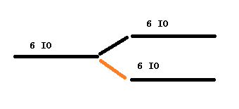

My customer need a mux which can support 6 input, 12 out (two 6chs), the signal is 3v, 100Mhz. please kindly recommend a high performance-cost ratio device. thanks.
Hi Yue,
Does your customer need a devices that hs 6 inputs and 1 input between 2 outputs such as a mutli-channel 2:1 device?
Here is an example of a 2:1, 4-channel device. Some customers will call this a 4 input, 8 output device.
A device like this will take one input and switch it between 2 outputs.
Is this what the customer is looking for? Or do they need a device that takes 1 input and buffers it onto two different outputs simultaneously?
Hi Yue,
I would recommend the TMUX1574 x2 devices in QFN for the system to have best tradeoff of high BW, 6 channels, and small size.
If the customer wants a single device they can use the TS3A27518E.
