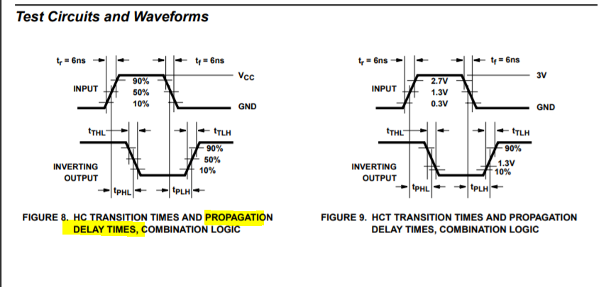

Hi all,
I want to know what is the sampling rate of cd74hc4067
or if I used 1 channel what it the sampling rate?
What is the Frequency and time for this IC??
  • Hi Rathang,
    The switch bandwidth spec is covered in the datasheet table along with the frequency response curve::
    If you are looking for time to switch between the channels, you will look at the propagation delay specs and the fall/rise time for this part.
