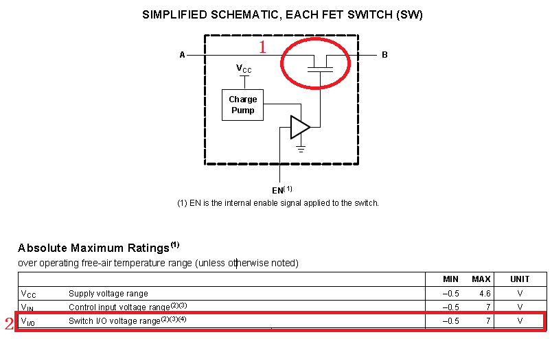

1. whether the input is the mosfet structure?

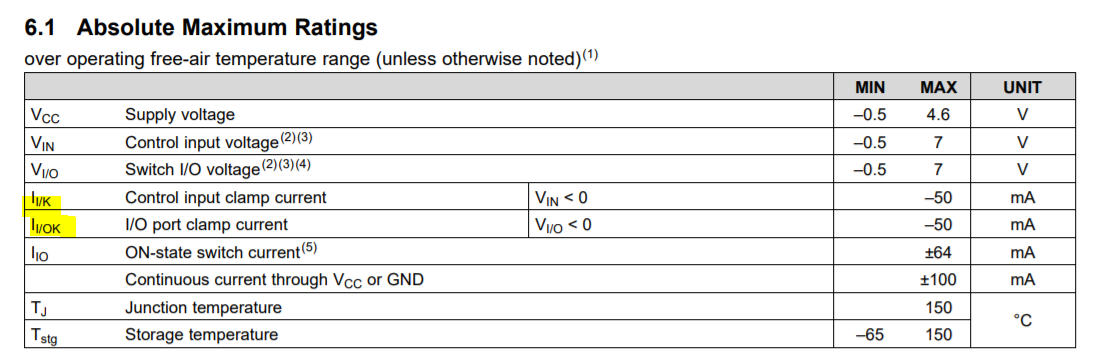

2. whether the input can accept higher negative voltage -2v with smaller time(20ns)?

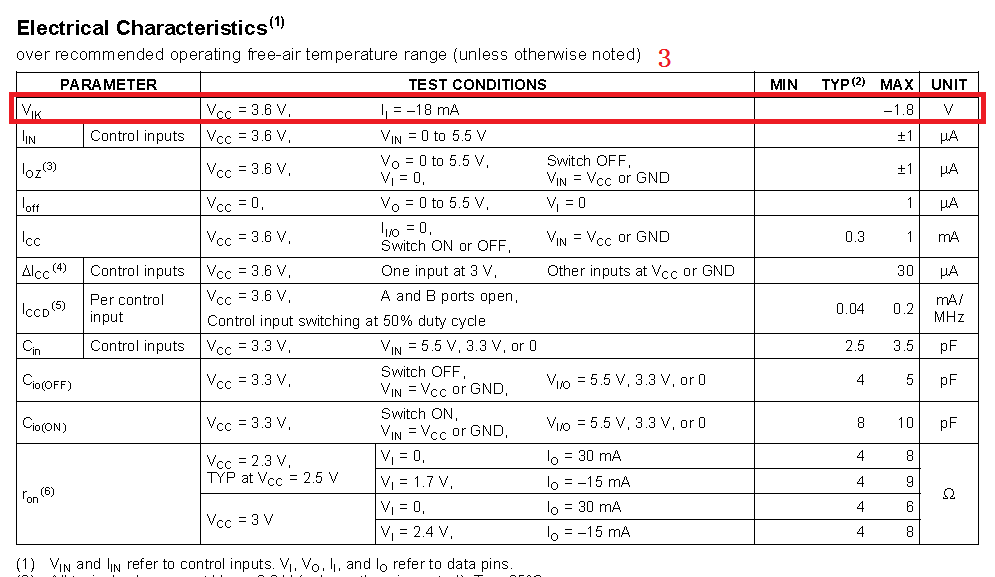

3. What's the meaning of VIK?-1.8V.

    The SN74CB3Q3125 is an NMOS series switch with a charge pump. The charge pump elevates the gate voltage of the pass transistor, providing a low and flat ON-state resistance (ron).
    The recommended input voltage range for the  SN74CB3Q3125 is 0V-5V.
    Also note the II/OK current max is -50mA specd at VI/O < 0. What this means is that clamping diode from Vin to GND will kick in and clamp negative voltages upto -50mA max.
    VIK is undershoot voltage of this device which is -1.8V when Vcc=3.6V.

  • hi Saminah,
    whether we can consider the I/O can accept VI/K to -1.8v if the current is below 50mA? Thanks.
  • Hi Frank,
    If you look at the note below the Abs max ratings, the input and output voltage ratings may be exceeded if the input and output clamp-current ratings are observed, however for better performance, it is recommended that part functions under the recommended operating conditions.
