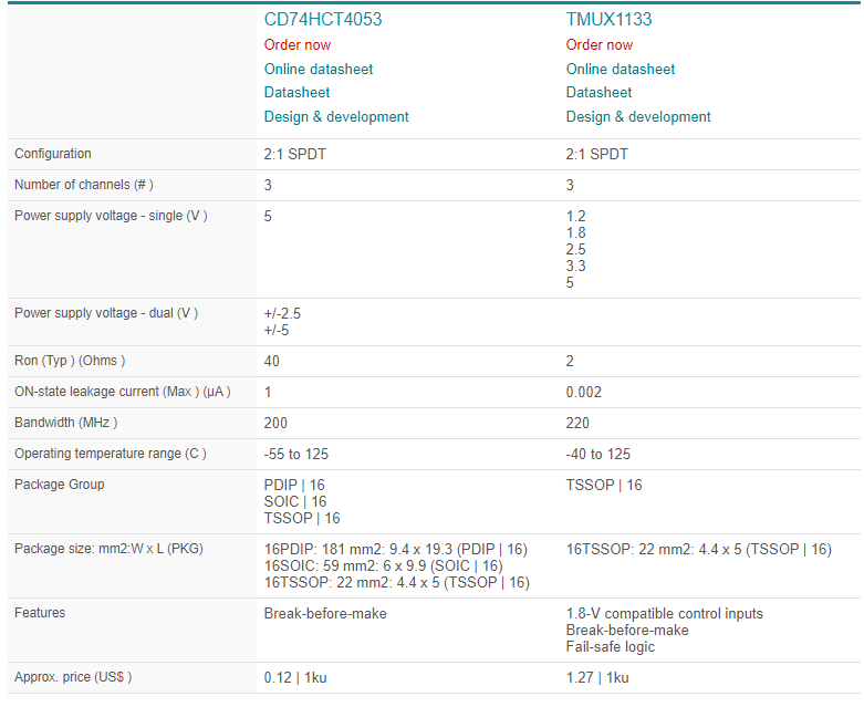

PN: CD74HCT4053 ESD HBM is ±500V? I don't think it's that low,Can you help confirm it. Thank you.
Hi ;
The datasheet shows that the actual rating for the ESD HBM is +/-500V.
Are you looking for a device with a higher ESD HBM rating? I would be happy to recommend an alternative device.
Kate
Hello Kate;
The end Customer use CD74HCT4053 to test in progress。 but now find ESD HBM is +/-500V;The customer thinks it should not be so low.
Is there a mistake in the specification? Is this IC ESD HBM that small?Which model do you recommend? Can P2P completely replace CD74HCT4053? Thank you.
