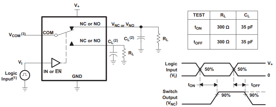

I am now doing some stress testing on TS3A5018RSVR  EVM so that switch frequently changes status (repeating on/off).
Do you have data/information that is the maximum switching times of the switch?  the switch frequently changes status means (repeating process of changing NC and NO)

  • Hi Adam,
    Thanks for your question. For this device, the transition time (or switching time) can be found as turn-on time (tON) and turn-off time (tOFF) in the switching characteristics tables. In this case**, tON/tOFF is the time taken for the switch to react to a change in logic input, IN or /EN. You can find the minimum, typical, and maximum tON/tOFF time according to supply voltage in sections 6.9, 6.10, 6.11 of the datasheet. Check out the figure below to learn about the test setup for this characteristic.
    What is the customer's application/end equipment? I would like to suggest taking a look at TMUX1574 if you are interested in a device with lower Ron, lower leakage current, higher bandwidth, and more features, such as powered-off protection and 1.8V logic compatibility.
    Let me know if you have any additional questions!
    Kate
    **Take note that transition time may be indicated by a separate characteristic, Ttran, in datasheets for other devices. To learn more about timing characteristics, watch this video!

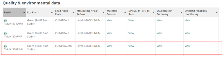

  • Hi SHH,
    Are you interested in the reliability information for TS3A5018 or TMUX1574?
    For any device, you can find quality and reliability information in the product folder in the "Quality & packaging" tab. The information is organized according to package. I've included a screenshot of the table for TMUX1574, view the information for TMUX1574 by following this link to the product folder
    From this table, you can access the Qualification Summary and reliability monitoring tables.
    TS3A5018 quality & packaging information can be found here.
    Reliability terminology, testing, and other general informational resources are located here.
    Take a look and let me know if you find the information you need.
