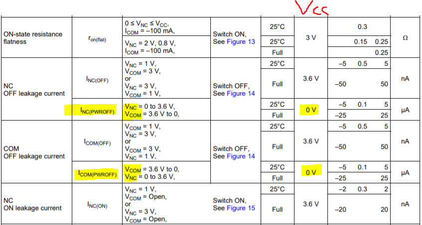

    In the datasheet for TS5A3167 I see the following:
    - Chapter 6.1 "Absolute Maximum Ratings": VNC, VCOM "Analog voltage range" -0.5 to VCC+0.5
    - Chapter 6.3 "Recommended Operating Condictions": NC, VCOM "Analog voltage range" 0 to VCC
    - Chapter 6.7 "Electrical Characteristics for 3.3-V Supply": INC(PWROFF) = ICOM(PWROFF)  is specified to max +/-25 uA
    The above seems slightly "inconsistent", i.e. in chapter 6.7 a voltage of VCC+3.6 V is applied and this is not allowed according to chapter 6.1 or chapter 6.2
    Is a voltage of VCC+3.6 on NC or COM pin allowed only when VCC = 0 V?
    What happens in this case if VCC = 1 V or in a transition to VCC = 0 V?
    Perhaps the requirements in chapters 6.1/6.2 is only applicable when the switch is ON?
    What happens in that case if the switch is ON and then power is lost to the unit this switch is located in and power is still available on NC and/or COM in the transition to VCC = 0 V?

  • Hi John,
    The Absolute Maximum Ratings and the Recommended Operating Conditions analog voltage range is specifying what input signal is supported by the switch when a VCC is applied to the switch and highlighting what is the absolute max input voltage the switch can take and what is recommended when the switch is ON.
    The I(PWROFF) spec is specifically for the switches that support powered-off protection. Meaning when VCC=0V, there will be high impedance on the I/O pins and logic pins to protect the system from damage.
    The Table 6.7 with INC(PWROFF) and  ICOM(PWROFF)  specifies +/-25 uA leakage current with Vcc = 0V showing that the I/O signal path is Hi-Z when a voltage from 0V-3.6V is applied to NC or COM at VCC=0.
    Here is a link to an FAQ that explains powered-off protection with Ioff spec.
    If the switch is ON ans power is lost, as soon as VCC hits 0V, a high impedance (Hi-Z) path is created between the input and output (I/O) signal paths and system power rails.  This prevents back-powering conditions when the voltage on the I/O signal paths are greater than the supply rail (VCC).
    Hope this explains your questions.
    Saminah
