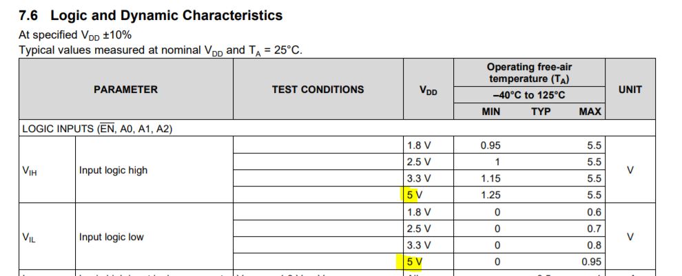

My customer has one question about SN74HC4851-Q1, what is VIH min and VIL max when Vcc=5V? There is no data in datasheet EC table, could you please provide it?

Hi Johnny,
That is correct - The 4.5 V values are meant to apply to 5 V ± 10 % power supplies.
I would also recommend looking at the TMUX1308-Q1 device which is exact equivalent in functionality and parametrics to the SN74HC4851-Q1 and has VIH and VIL specified at Vcc = 5V.

Thanks Saminah and Clements.
This question is from an ongoing project that already finished device selection already. We will take VIH_min=3.5V and VIL_max=1.5V when Vcc=5V.
