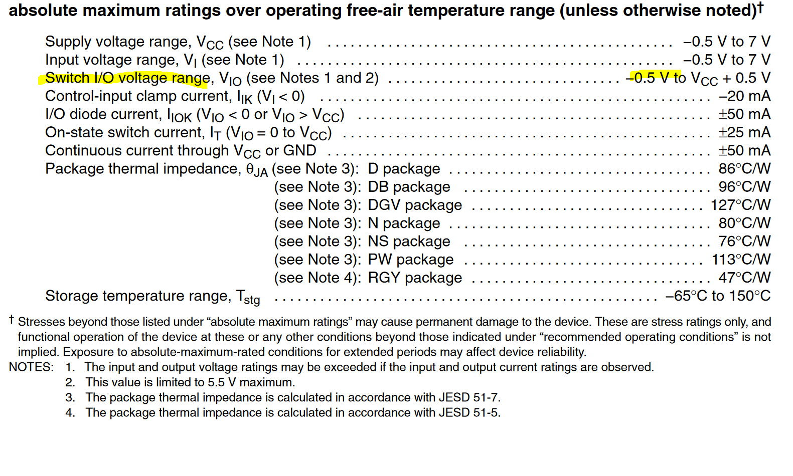

Our customer is going to use this device for signal mixer. (That is a kind of modulator or demodulator)
Then we have some question.
 1. Can this device allow to input the negative signal. (e.g. AC signal : 1MHz , +/- 3V)
      I understand the input voltage range is defined at datasheet.
 2. Do you have any reference circuit for signal mixer using this device?
* condition
    AC signal (+/- 3V)  -- [Analog switch : SN74AHC4066] --- (filter) --- MCU (ADC input)
           clock input (to analog switch)------|
      (The frequency of AC signal is same as the clock input (=sample clock). This means it is a direct conversion.)
Could you give us any advice if you have any information for this?
