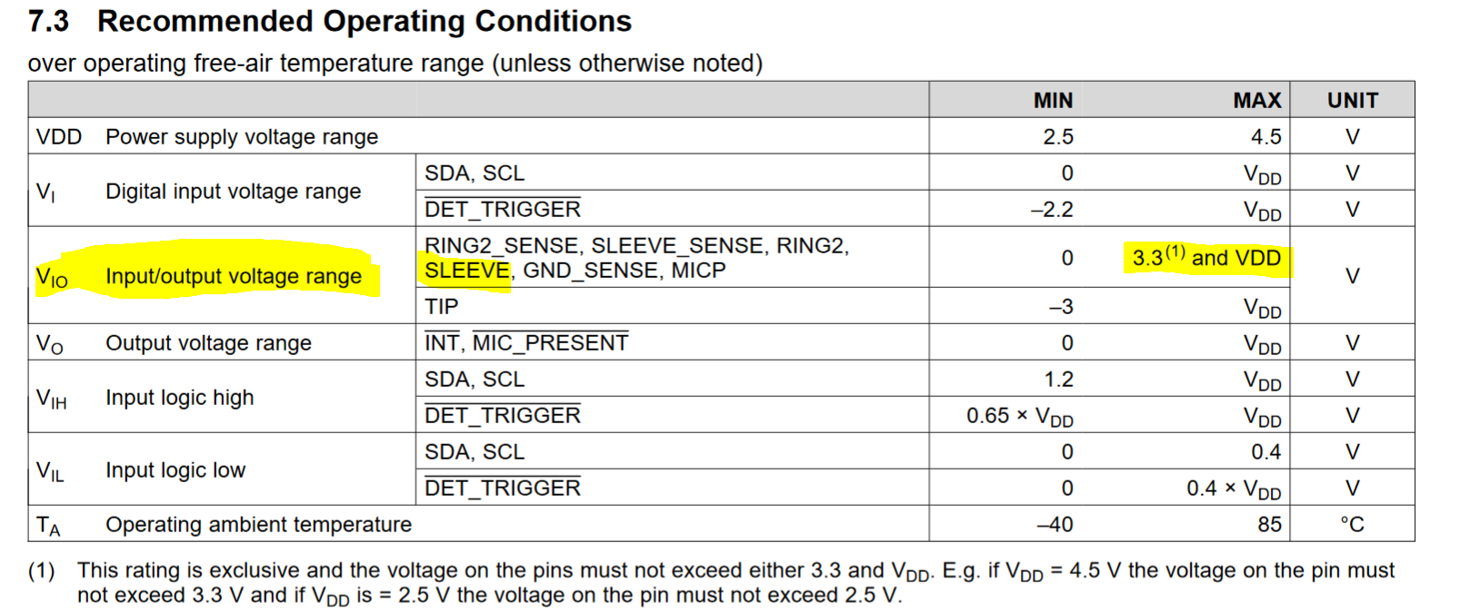

Can the TS3A227E interface be used to implement UART communications, over the head set jack audio path to allow debugging?
Will it detect the 3.3 V on the SLEEVE contact vs. the 600 Ω ~ 4 kΩ impedance it's looking for?
We would like the switch matrix in the TS3A227E to pass the 3.3 V through to the MICP pin, where it can be detected to actuate a mux scheme to switch the Left / Right  lines to be UART TXD and RXD.
Please advise if applying 3.3 V to the TS3A227E SLEEVE contact will achieve the desired result.

    Placing 3.3 V on the sleeve pin does not violate the datasheet recommendation with VDD >=3.3V
    I will need to know what is on ring2 in your use case to help determine how the TS3A227E automatic detection will behave.  Note you may always use the I2C control to mannually configure the switch to connect SLEEVE and MICP.

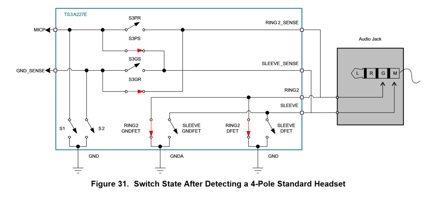

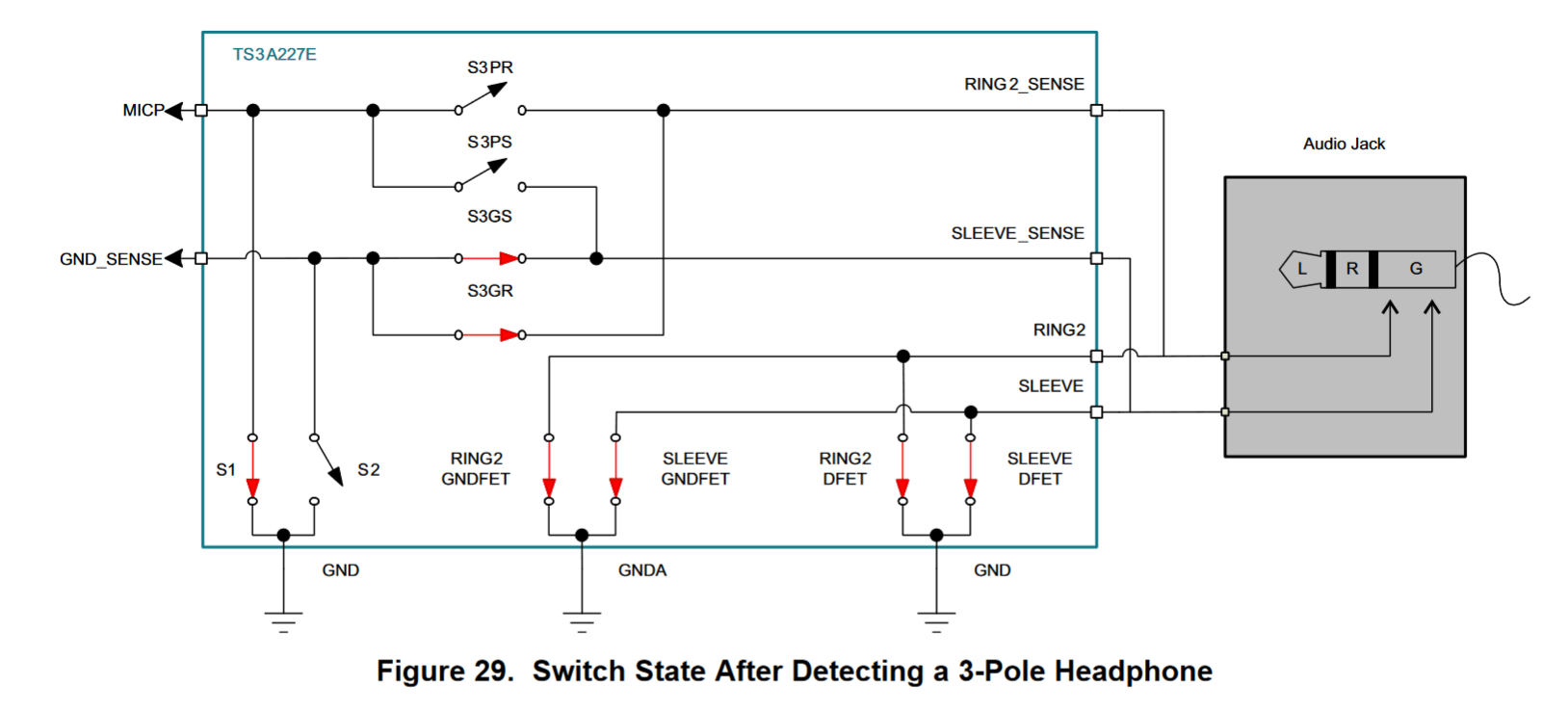

    If the TS3A227E device configures itself for a three pole configuration it will ground the sleeve pin and not pass 3.3 V
    If the device configures it self as a 4 pole OMTP device it will ground the sleeve pin and not pass the 3.3 V signal.
    In order to pass 3.3 V through the sleeve pin to MICP you need the device configured for a standard 4 pole device so it does not ground the sleeve pin.  You may always manually configure this device through the devices I2C communication pins.
    I'm still looking into how the device will automatically configure it self when it sees 3.3 V on the sleeve pin.  In your use case what is present on Ring 2.  As you can see from this post below the audio jack detection configuration is based on a comparison from what is connected on sleeve and ring2.
    Thank you,
    Adam
  • SLEEVE will be 3.3 V and RING2 will be ground.  The question is whether the TS3A227E can detect this voltage and configure itself to the switch state shown in Figure 31 without software intervention.
