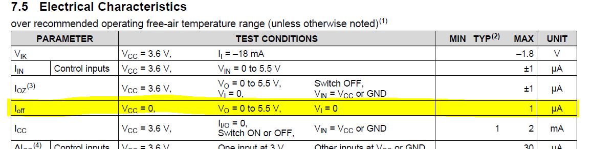

    For SN74CB3Q16244, when Vcc = 0V, the signal path will be in a high impedance state.

    Hot insertion and hot removal in my scenario means the device on the board is subcard, the subcard could be inserted or unplugged to backplane board. Back plane board will provide this subcard power.
    I reviewed the link you sent in the reply. it is same as below:
    "Usually a card or a board gets inserted on a backplane connector while power is on (what we call live insertion). This means that the device is exposed to many different things which could include signal on the Input pins without power being applied. Also, there could be small transients caused by board parastics during live insertion that could cause latch up if the IC circuit isn't designed for this. A lot of our TCA parts will call out exactly that they can handle this (different functionality though). "
    so the data sheet describes when VCC=0, signal path will be in high impedance, so this mean it could support hot removal. how about hot insertion?

    The SN74CB3QXXXX devices have an internal charge pump that bias the gate of the FET. This FET will not turn on until the Vcc reaches a threshold to power the charge pump. The signal path will remain Hi-Z until the charge pump turns on so if you are pluging the switch into a system that is powered the switches I/O pins will remain Hi-Z until about a 1V when the charge pump will turn on.
    Will this behavior be acceptable in your system?
    Do you see any system issues with an AC signal coupling through the switch I/O path when Vcc = 0V?
    Adam
  • Hi Adam,
    I think this will work for back plan hot removal and hot insertion.
