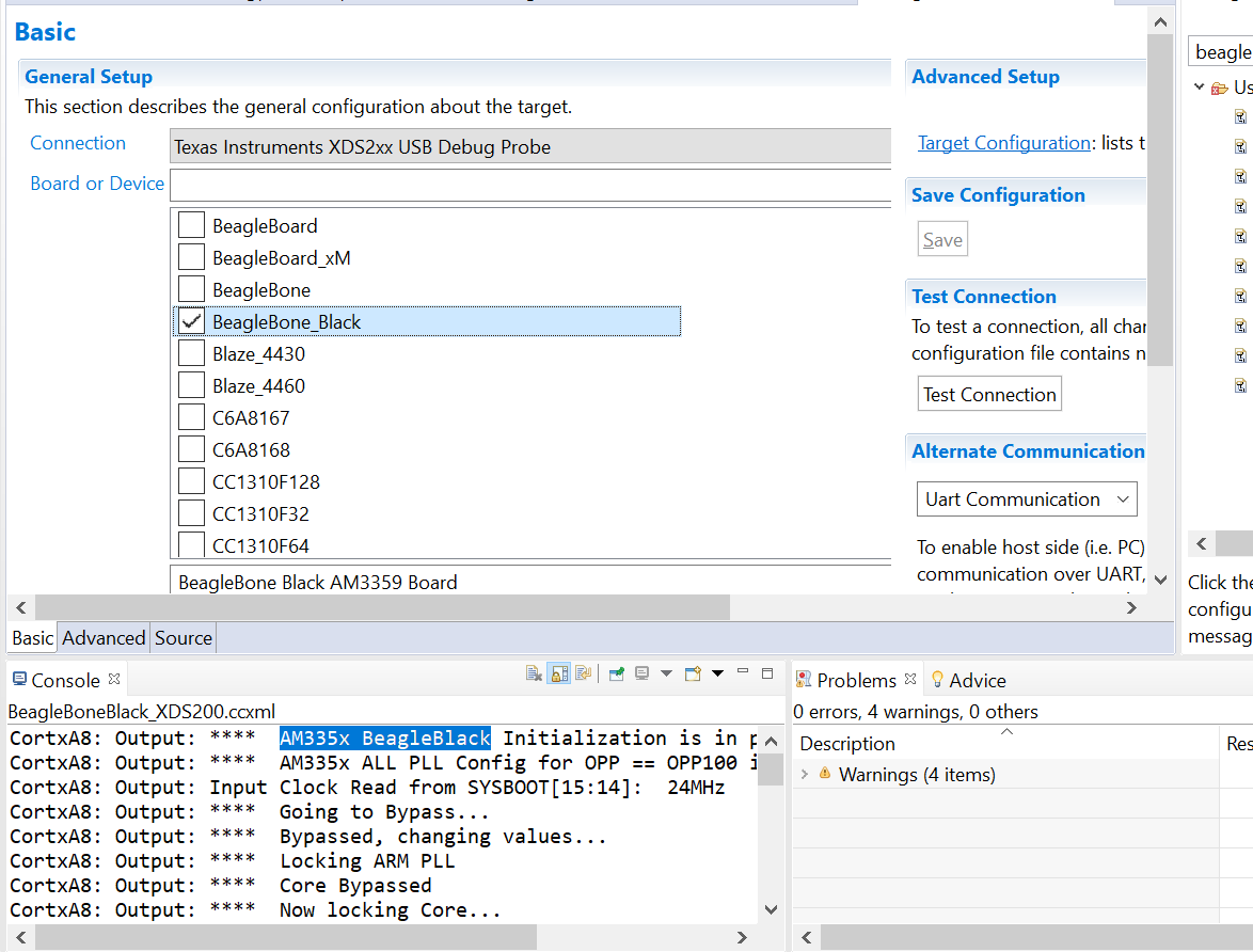

  • AX,
    You are on the right track by selecting a board configuration instead of a Device.
    Are you using a BeagleBone or BeagleBone Black? I think their external memories differ and therefore the configuration with the BeagleBone Black should be functionally sound.
    Please give this a try.
    Hope this helps,
    Rafael
  • Hello Rafael, I am using Beaglebone Black Rev B. Should I try with Rev C instead ? If I am not mistaken the only difference between rev B and C is the eMMC size. Any hints ?
    No, I meant using the BeagleBone Black configuration in CCS:
    The giveaway that you are using a different configuration is the message printed at the top of the initialization script. It should read "AM335x BeagleBlack Initialization is in progress" instead of " AM335x Beaglebone Initialization is in progress"
    Rafael
  • Thank you so much for pointing out that. My mistaken for not paying attention to the "bbb black" variation.
