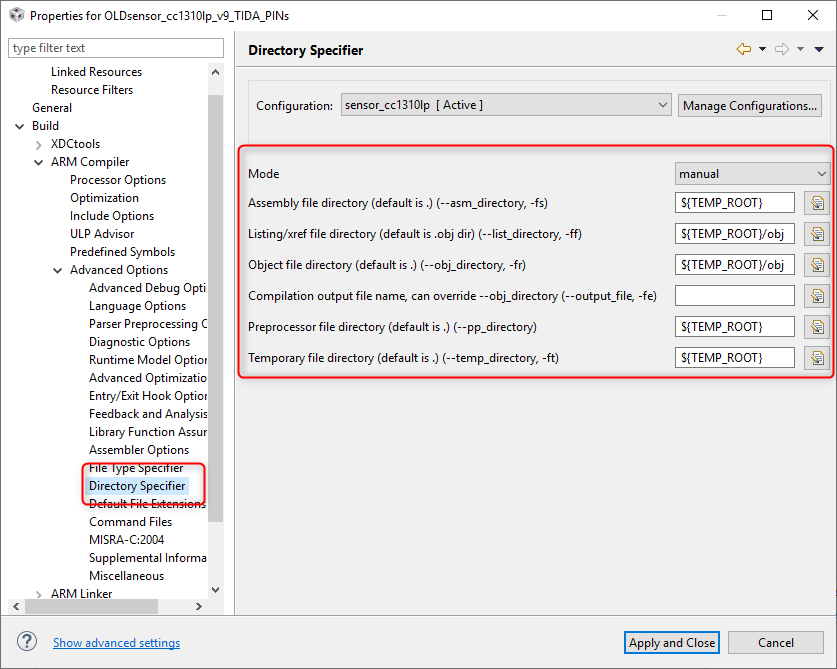

Hey guys,
I use CCS Version: 8.3.0.201810301800  Build id: N201810301800 and I recently downloaded and installed the 3.10.00.11 for CC1310. My system is Windows 10 64bit Pro. From then on, I was not able to build two particular older projects (we call them P1 and P2), which are the most important unfortunately. These two projects are within a local repository. The repository is not located in the standard workspace folder of ccs (C:\User...\Documents\CCS\Workspace\...) but in another. And this is what is different to other projects in my CCS project explorer.
If I important an older version of P1 or P2 into CCS they build fine btw. If I go into project properties -> Resource and check the location, it points to the git repository folder and when I want to build the project I get the following error for all obj files:
No rule to make target 'C:/Users/.../Documents/CCS/Workspace/sensor_cc1310lp_v9_TIDA_PINs/sensor_cc1310lp/obj/board_gpio.obj', needed by 'all'.
and this error for several times for all subdir_rules.mk files, too.
 *** mixed implicit and normal rules: deprecated syntax    subdir_rules.mk
It is interesting, that the error points to the original Workspace of CCS.
I assume some compile settings have been mixed up somehow during installation and/or import of the new SDK?
What I tried so far
  • Setting the computer back to an old restore point before the installation of the sdk
  • Using an older commit in the Git history didnt work
  • Copying the backup files into the git workspace
My questions:
  1. Any idea how to solve this issue with the errors
  2. Could I import an old version of P1 and P2 into CCS and set them as the head of the git history of P1 and P2 somehow? Not sure if this makes sense, but I dont want to loose my git history and just use the backup and create a new git repository)
Hope you guys can help me
kind regards
Slev1n

    Can you share your project? I just need the project metadata files for now (the 3 .*project files inside the project folder).
    ki
  • I've attached the files, however, further details relating to the project contain IP so if you need more I'd like to send to you via PM.
    Thanks for your help
    sensor_cc1310lp_v9_TIDA_PINs.zip
    When the projects are imported into the workspace, the option to "copy into workspace" is NOT enabled I assume? That the projects are left in their original location?

    When you mention "original" Workspace, this is not the current workspace that is being used?
    Also, what is the current workspace location being used?

  • I just noticed that if I go into the properties of my project -> Resources -> Linked Resources -> Path Variables (tab), the Workspace is set to C:\Users\XXX\Documents\CCS\Workspace...So the project's workspace is the original one. However, under -> Resources  the path is different and points to my git repository folder
    EDIT:
    If I copy the project folder out of the git repository into my original CCS workspace ..documents\CCS\Workspace\... it compiles fine without error. I did then change the git repository location to : C:\0_Git_Repositories\CC1310_Sensor_example_sdk2\sensor_cc1310lp_v9_TIDA_PINs
    So no non-alphanumeric stuff. But again, I cannot compile and get the same errors as before.
    This tab is good to check. Make sure all the variables here point to valid locations. Because you imported from Resource Explorer to your workspace, and then manually copied the project into your repo outside the workspace, some variables may not be pointing to the correct location.
    Also check your directory specifier options. Make sure the paths are correct, especially for the object files. Make sure {TEMP_ROOT} points to the location you are expecting (it is defined in the Path Variables tab you mentioned before. You can also try setting the Mode to "automatic"
    ki
