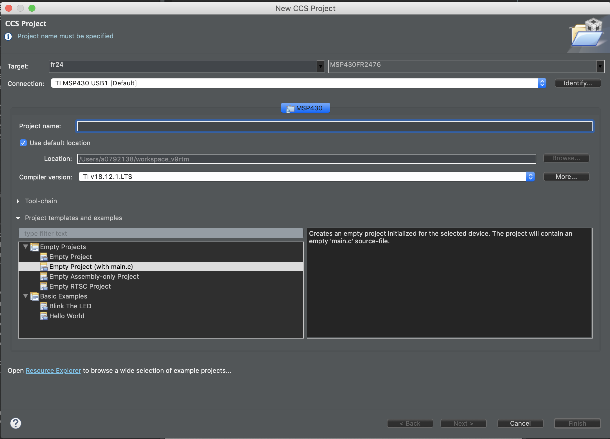

    I see MSP430FR2476 in my CCSv9.0.1 installation.
    Here it is in the Project Wizard.  I typed fr24 in the filter box to get to it more quickly

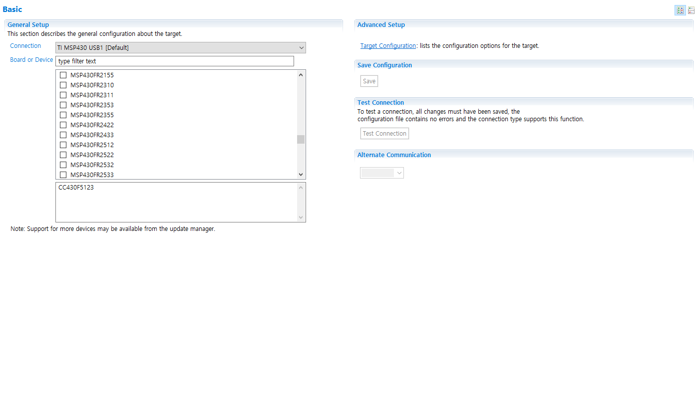

    Similarly in the target configuration editor:

    Do you see any other MSP430 devices listed in the Project Wizard?  If not then you may have missed installing support for MSP430 when CCS was installed.  If that is the case you can run the installer again and point it to your existing installation and it will allow you to add support for MSP430.

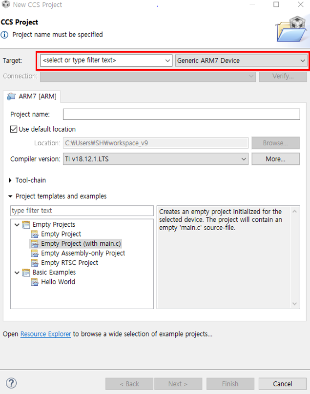

    The tools are different.
    I am a tool like a photo material, but there is no target in the red box.
    The MSP430FR2476 chip is missing from the Board or Device because I want to perform target configurations in the way that the zone gave me.
    Please check the attached picture.
    It should not be downloaded by providing TI for MSP430.
    Leave a comment.

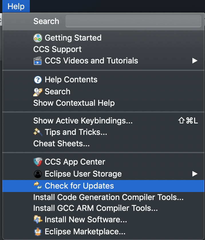

  • That is really strange.  The device should be there.  I had another person check on their machine and the device was there as well.
    Can you do a check for updates and install the latest MSP430 related updates.  On the Help menu there is a "check for updates" menu item.
    john
  • Thank you. I solved it with your opinion.
