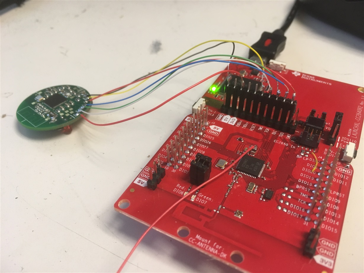

I was building a custom board with the CC2640R2F chip. I am trying to program the chip via the LAUNCHCL-CC2640R2 board. I use following connectors: GND, 3.3V, RESET, TMS, TCK,TDI and TDO.
Unfortunately the error "Unable to access the DAP" appears.

  • Those are the correct connections.
    To confirm I just setup a CC2650 LaunchPad and made those connections to my CC2640R2 LaunchPad.
    I ran the Test Connection tool from inside CCS and that passed.
    I then tried the pwmled example from the SDK and that worked fine as well:
    Seems like there is a bad or noisy connection.

  • Hi John,
    I did the same test with 2 Launchpads, like you did, and it worked fine. But when I am using my own custom made board, it still shows the DAP error.
    Testing the connection in CCS is working.

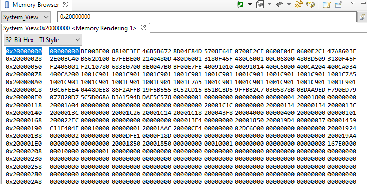

    8. If you expand core registers. Do the TAP registers have values other than 0 or 1?
    9. Next select the DAP under "Non debuggable devices" and see if you can connect to that.
    10. If that works can you open a memory window and see if you can go to 0x20000000
    John
    1. The tap registers inisde of ICEPick_C have other values than 0 or 1. See pic.
    2. Accessing the memory at address 0x20000000 of  DAP was also working
  • Well that is good.  You actually connected to the DAP without an error.
    If you go back to the Debug View and select the Cortex M and connect what happens?
