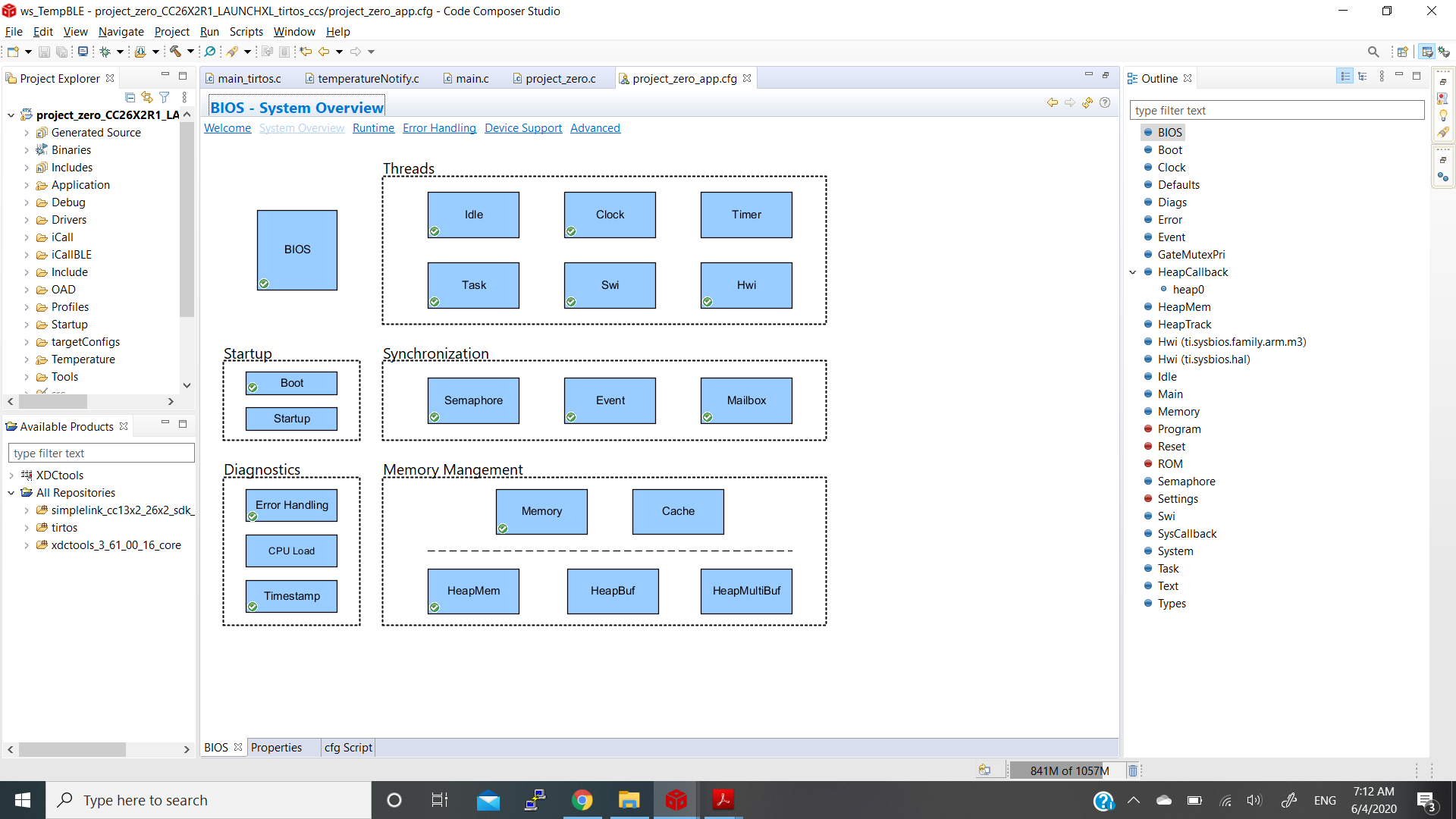

I am trying to build a product using "project zero" example application under TIRTOS, BLE5 path. Using CCS10.0 as my environment.
My objective is to add mailbox support and create a mailbox to act as a means to interconnect ISR and application task. Hence opening the "project_zero_app.cfg" using XGCONF tool in CCS.
After opening *.cfg file, i see the following view. When I compare with that of RTOS user manual (SPRUEX3U—February 2018 ) they do not match.
1.) Available product view does not match, I do not see TI-BIOS in top level ( I only get XDC tools and Other products). I doubt my with my installation.

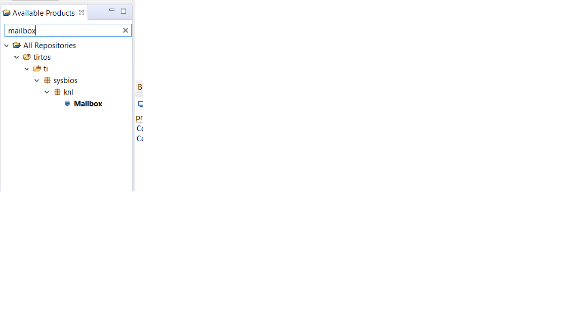

2)Path of mailbox is not matching with manual.
3)When I click on the mailbox I get a screen where I am not able to edit mailbox details. So I tried clicking mail box in "available products" view and drag into outline view. Then it allows me to edit. Not sure these are right way to do.
4)I have added posix support in this project. Can that be reason?
Please let me know what is wrong? Thanks in advance.

    I am trying to send temperature threshold notifications from launchpad to a mobile app through Bluetooth Low Energy interface.
    My application is a combination of project_zero and TemperatureNotify. I am trying to transfer temperature notification and actual temperature values from call back function of TemperatureNotify to project_zero thread. It needs an IPC and I am using mailbox message (and an affiliated event) from callback functions to BLE5 specific threads of project_zero (an application).
    I have merged both app and built the combined code (I had many issues in the process of doing so). I am currently testing and progressing still not sure  what I am doing is correct and it is recommended way.
    I am attaching all the images here. Thanks for support.

    Image 1)
    Image 2) Mail box path:

    For the last several years we've recommended that users edit the .cfg as text file. The XGCONF GUI has a few issues that we've tried to address, but have we've focused resources in other areas. Part of your issue is that the .cfg is using the kernel in ROM, so Mailbox is present implicitly, but not explicitly in the .cfg, so the GUI is getting a little confused. You can just add the following (variable names and sizes changed as needed) directly into the .cfg file (and add nice comments...another advantage of treating the .cfg as a text file).
    var Mailbox = xdc.useModule('ti.sysbios.knl.Mailbox');
    var mailbox0Params = new Mailbox.Params();
    mailbox0Params.instance.name = "mailbox0";
    Program.global.mailbox0 = Mailbox.create(32, 4, mailbox0Params);
    Then in your code you can reference the statically created Mailbox.
    #include <xdc/cfg/global.h> // needed to get the global from the .cfg file
    #include <ti/sysbios/knl/Semaphore.h>
      Mailbox_post(mailbox0, msg, TIMEOUT);
    Todd
