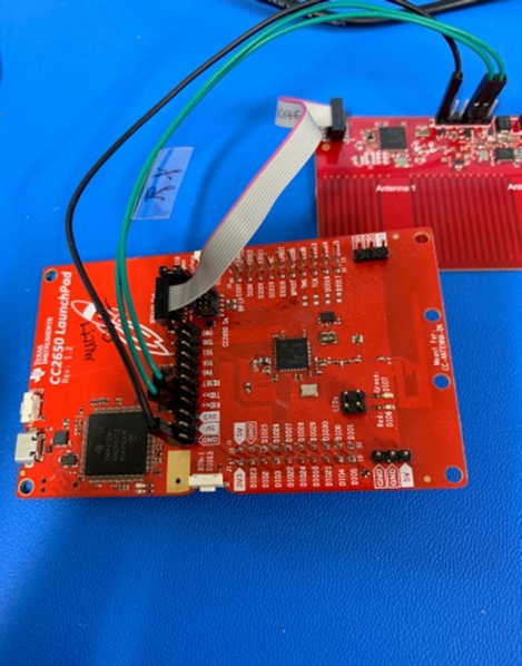

Hi,Ti partners:
We have made the evaluation board of TIDA-01632, how to set the SW debug environment by hardware?
Do we have to need the board of CC6240R or CC6250?
We don't have the CC6240R or CC6250, can TI provide if needed?
mike feng1 said:We have made the evaluation board of TIDA-01632, how to set the SW debug environment by hardware?
To debug the HW, you will need an XDS debugger, ex. the xds110 available on the CC26xx launchapds.
mike feng1 said:Do we have to need the board of CC6240R or CC6250?
Yes you will need one to debug the TID. Also, please make sure to review this post e2e.ti.com/.../3134173
mike feng1 said:We don't have the CC6240R or CC6250, can TI provide if needed?
Let us discuss internally and we will get back to you.
Hopefully this helps.
David
This is covered in chapter 2 and chapter 3 in https://www.ti.com/lit/ug/tidue70a/tidue70a.pdf
Basically you need a XDS110 to program the CC2640R2 and any CC13xx/ CC26xx launchpad could be used for this.
