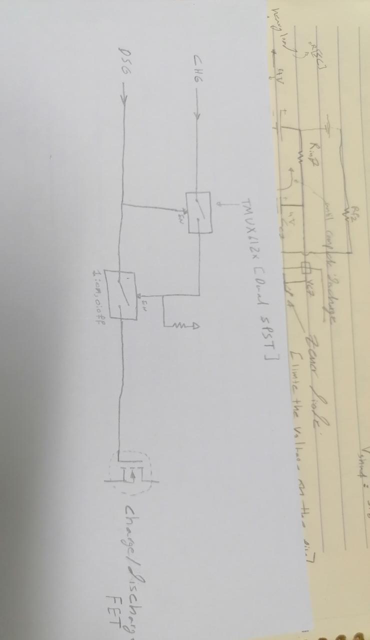

    But I don't think that the first question is answered well or maybe I don't get the point since I know the situation where we need to use both discharge and charge protection FET, but I don't understand the need of them in common charge/discharge path? as in  TIDA-00792 and TIDA-00449. or we just forced to use them like this because of the behavior of the chip itself? "Table 1. CHG, DSG Response Under Various System Events" in the datasheet. If just forced to use them like this, so this idea can help or it's not a good and practical one(as in the picture below, with pull-down Resistor on FET gate)?
    Rashad Shubita
    Maybe something like this is better, right?

    I'm uncertain of your complete topology, that is for you to work out.  Remember that a FET blocks current in only one direction, in the other direction it is a diode. So a single FET can not prevent both charge and discharge.  A pair of FETs with the sources connected can block current in both directions and provide a single control if appropriate.  FETs connected with a common drain will typically need separate control lines such as the FETs shown in TIDA-00792..
    In your first drawing as amended in the second, it is the resistor on the gate of the final FET which turns it off if CHG goes low.  In your second drawing remember that REGOUT is a low voltage (varies with the part number selected) while CHG and DSG are about 12V if in regulation.  Be sure to keep the logic and the PNP safe.  It does not leave you much gate voltage for the FET shown.  Again realize it is the resistor shown to GND which turns off the FET.
    Think through what you plan to do.  A simulator like http://www.ti.com/tool/TINA-TI or others available in industry may be helpful to understand FET switching, but be cautious of the transistor models, some show high leakage, you still need to test to validate your circuit.

    Again thank you very much! now everything is clear to me. I really forget the body diode in FET.  Nice explanation thanks!. Can you give me a good reference where I can understand FET switching really good? and all consideration I need to take, also FET driver?
