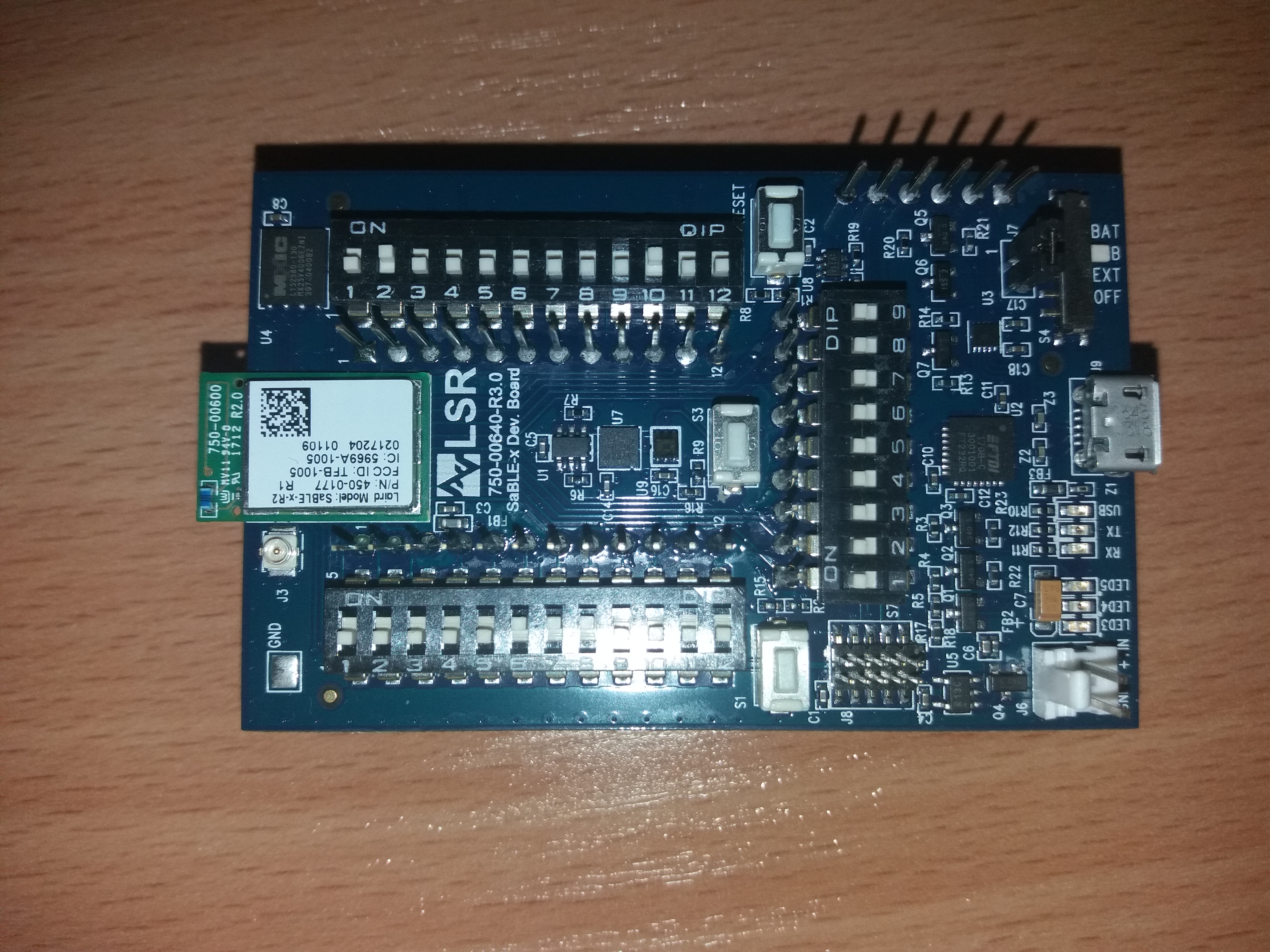

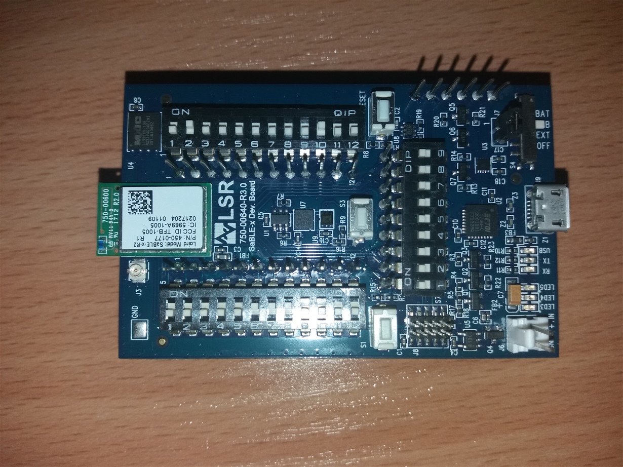

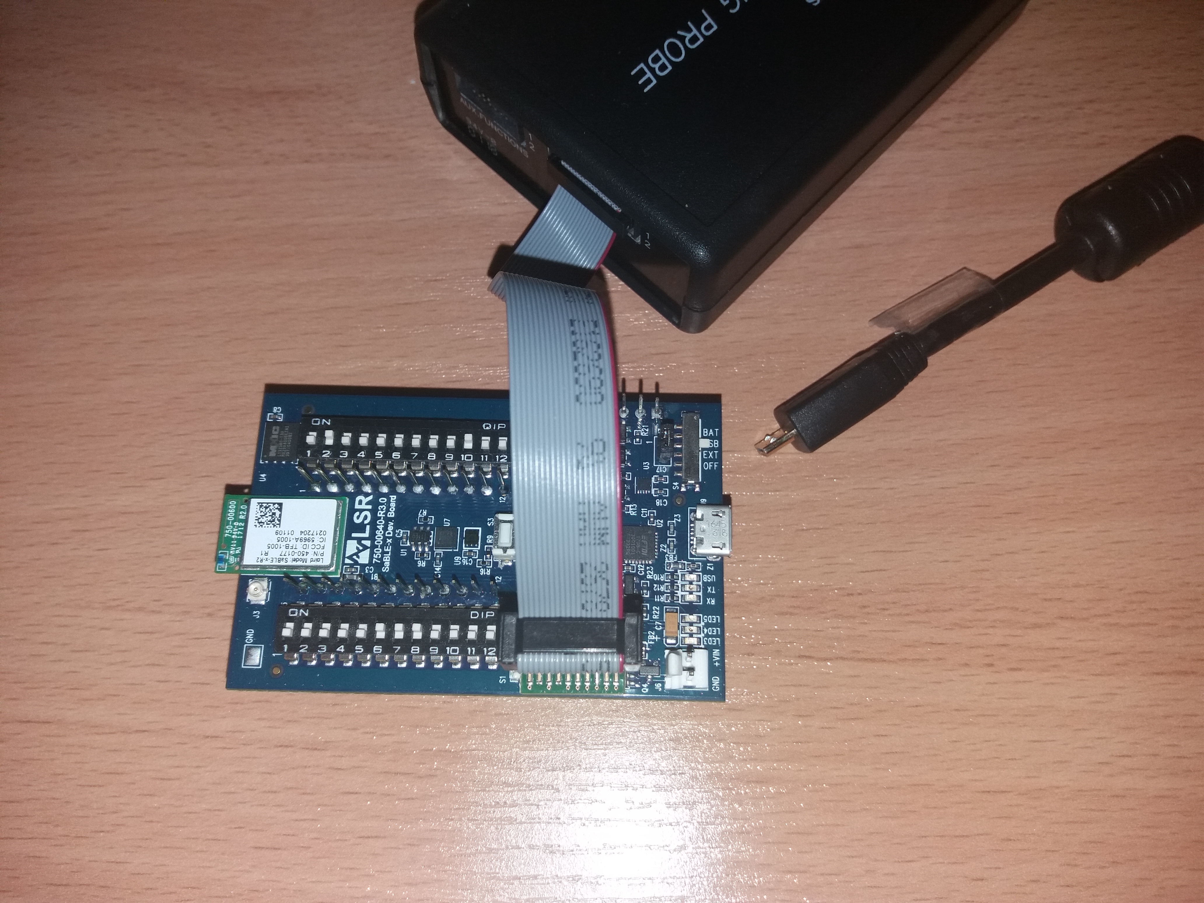

  • Well, i have no special schematics. In the pictures below you can see the connection configuration of the XDS110 and the usb to the PC. The other picture represents the switch setup for the board bootload.
    Regards Alen

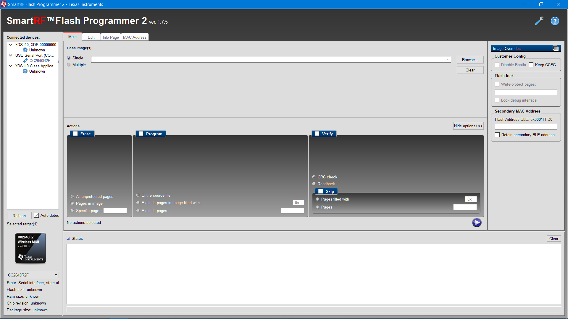

  • If you use Flash Programmer 2, can it recognize your CC2640R2F?
  • I have installed the flash programmer 2, and I thing due to the ooutput on the picture, that it can see the development board. I should also mention that as you can see the XDS110 is also visible and that I have not connected the dev. board with the XDS110 while taking this screen shot.
    Regards Alen
  • I couldn't understand your reply. Can you reply if Flash Programmer 2 can recognize your CC2640R2F?
  • I'm so sorry I thought I have uploaded the screen shot.

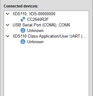

  • CC2640R2F doesn’t show on XDS110 tree view which means There’s something wrong on JTAG connection. I suggest you to check JTAG connection first.
  • The JTAG wasn't connected. Now it is, and it is shown.
  • It looks good now and you should be able to use CCS to do trace/debug examples now.

  • Do you have a CC2640R2F LaunchPAD? I do not have access to the module HW that you have so its hard for us to replicate it.
    I do not know why there are 3 UART ports, because we typically only have two.
    /TA
    no I do not have your Lounchpad, I have the LSR development board with your (TI) processor. I think I have solved my problem. Before entering the debugg mode, one should have established a connection with the RealTerm serial monitor. One should connect to the port designated to the board alone( USB serial port COM6), not the port designated XDS110 class .../User UART(COM4). And when you have output on RealTerm you go and click debugg. It wont crash any more. So not after clicking on debugg but before it, connect the board with the serial monitor. And for the debugging itself of the code I think that it is a mess, becouse it is for an unknown reason not possible.
    Regards Alen.
