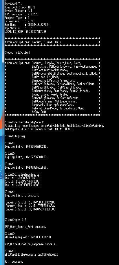

       I use the TI SPPdemo of CC2564B,Now I set the CC2564B terminal as the client and use the command SetPairability Mode 2 (Attempts to set the Pairability Mode of the Local Device to Secure Simple Pairing)。
      First,At the "Client>" prompt, enter Inquiry. This will initiate the Inquiry process. Once it is complete,I will get a list of all discovered devices.and then  find the index number of the device I need to connect to, and pass Issue a Open <index number> <server port number> command at the command prompt。
     After SPP is opened, the CC2564B terminal will send a pairing command to the mobile phone (Android platform). After clicking on the pairing, it can pair with the mobile phone. Next, we need to connect with the mobile phone.
     App (Blueterm) has been installed on the mobile phone. At present, CC2564B terminal is set in client mode. The Bluetooth on the mobile phone has been successfully paired. But CC2564B terminal can not establish a connection with APP. Do I need MCU to send a command to CC2564B terminal to establish a connection with APP on the mobile phone through Bluetooth? How to operate on mobile app instead?
     My problem is that CC2564B terminals are configured in client mode.After the Bluetooth of CC2564B terminal and mobile phone is paired well, how can I establish a connection with APP of mobile phone by modifying the program of CC2564B terminal?

          Your answer is that STM32F4+CC2564B terminal is used as server mode, which I have implemented。However, I set STM32F4 + CC2564B terminal as client mode. STM32F4 + CC2564B terminal has been paired with mobile phone in client mode. The whole process is shown in the following figure.
    but the APP on mobile phone is not connected with the STM32F4+CC2564B terminal. At present, we do not know how to establish the connection between STM32F4+CC2564B terminal and mobile phone APP?
    thanks your help.
  • Do, you mean it works for you when CC2564B is in server mode? but fails only in client mode?
    Please, check below thread, you may need to read the SDP descriptions from the server to get the RFCOM port for SPP to open the correct port:
    e2e.ti.com/.../2658746
