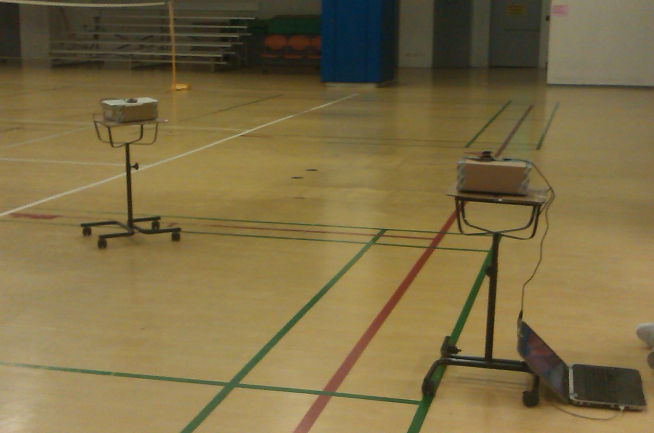

And test the aoa_reciver / sendor at same horizontal plane. But the angle variate large. I cannot got 90 degree under "90°". How can I improve it?
Real Angle (Degrees)
ANT2 ANT1
Distance (m) -22.5° -45° -67.5° -90° 22.5° 45° 67.5° 90°
2.8 m 5/-32 -42/-45 -46/-47 -17/-45 -4/-33 36/-5 -19/-33 -19/-47 -34/-48
5 m -6/-47 -42/-44 -29/-43 -29/-57 -19/-46 20/6 -7/36 -19/-34 -34/-46

  • I tested in a wide area, the third basement in my company, like following picture. It should be less multi-path here.
    I collect the data from the ("aoa: ") field in terminal. And only just use out of box software. Don't do other modification.
    And I never got the angle more than 70 degree. I am thinking about how can i got +90 ~ -90 degree?
